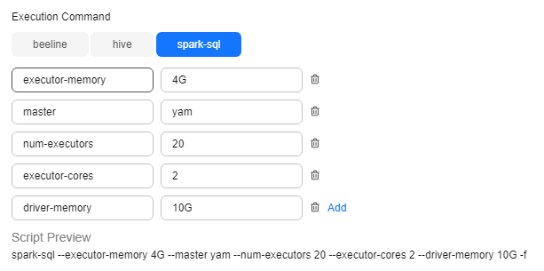

Assume that the total source data volume is 500 GB spread across 10,000 tables, in which there are 8 large tables with 50 GB data and 100,000 partitions. The master node has 8 vCPUs and 32 GB of memory.
- According to rule 1, the maximum number of concurrent requests is 5, which is the rounded down value of 5.6 (0.7 × 8).
- According to rule 2, you need to select spark-sql in the Execution Command area and set the following parameters:
executor-memory = 4G
master = yarn
num-executors = 20
executor-cores = 2
driver-memory = 10G
master = yarn
num-executors = 20
executor-cores = 2
driver-memory = 10G
master = yarn
num-executors = 20
executor-cores = 2
driver-memory = 10G
master = yarn
num-executors = 20
executor-cores = 2
driver-memory = 10G

Execution Command
You can configure Beeline or Spark SQL command parameters to run SQL statements for consistency verification.
- Beeline: a command line tool used to interact with Hive.
- Spark SQL: a command line tool used to execute SQL statements to query and analyze Hive data.

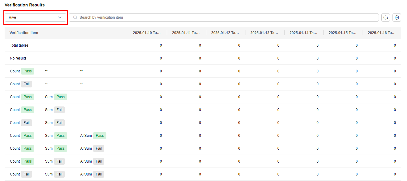

View the Summary of Verification Results
The following table describes the verification items displayed in the summary.
| Verification Item | Description |
| Total tables | The number of tables whose data is verified. |
| No results | The number of tables whose verification results are not obtained. |
| Count pass | The number of tables that meet the Count verification rule. |
| Count fail | The number of tables that do not meet the Count verification rule. |
| Count and Sum pass | The number of tables that meet both the Count and Sum verification rules. |
| Count pass, but Sum fail | The number of tables that meet the Count verification rule but do not meet the Sum verification rule. |
| Count and Sum fail | The number of tables that do not meet the Count and Sum verification rules. |
| Count, Sum, and AllSum pass | The number of tables that meet the Count, Sum, and AllSum verification rules. |
| Count and Sum pass, but AllSum fail | The number of tables that meet the Count and Sum verification rules but do not meet the AllSum verification rule. |
| Count pass, but Sum and AllSum fail | The number of tables that meet the Count verification rule but do not meet the Sum and AllSum verification rules. |
| Count, Sum, and AllSum fail | The number of tables that do not meet the Count, Sum, and AllSum verification rules. |
