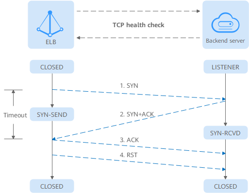

For TCP, HTTP, and HTTPS backend protocols, you can use TCP to initiate three-way handshakes to obtain the statuses of backend servers.
Figure 1 TCP health check
The TCP health check process is as follows:
  1. The load balancer sends a TCP SYN packet to the backend server (in the format of {Private IP address}:{Health check port}).
  2. The backend server returns a SYN-ACK packet.
    • If the load balancer does not receive the SYN-ACK packet within the timeout duration, it declares that the backend server is unhealthy and sends an RST packet to the backend server to terminate the TCP connection.
    • If the load balancer receives the SYN-ACK packet from the backend server within the timeout duration, it sends an ACK packet to the backend server and declares that the backend server is healthy. After that, the load balancer sends an RST packet to the backend server to terminate the TCP connection.
After a successful TCP three-way handshake, an RST packet will be sent to close the TCP connection. The application on the backend server may consider this packet a connection error and reply with a message, for example, "Connection reset by peer". To avoid this issue, take either of the following actions:

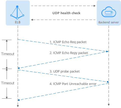

For UDP backend protocol, ELB sends ICMP and UDP probe packets to backend servers to check their health.
Figure 2 UDP health check
The UDP health check process is as follows:
  1. The load balancer sends an ICMP Echo Request packet to the backend server.
    • If the load balancer does not receive an ICMP Echo Reply packet within the health check timeout duration, the backend server is declared unhealthy.
    • If the load balancer receives an ICMP Echo Reply packet within the timeout period, it sends a UDP probe packet to the backend server.
  2. If the load balancer does not receive an ICMP Port Unreachable error within the health check timeout duration, it declares the backend server is healthy. If the load balancer receives an ICMP Port Unreachable error, the backend server is declared unhealthy.
  • If there is a large number of concurrent requests, the health check result may be different from the actual health of the backend server.
    If the backend server runs Linux, it may limit the rate of ICMP packets as a defense against ping flood attacks. In this case, even if there is a service exception, ELB will not receive the error message "port XX unreachable", and the server will still be detected healthy. As a result, the health check result is different from the actual health of the backend server.
  • The UDP probe packet's payload has no significance and is simply used to fill the packet with data. Typically, the payload is set to "H". Clients should not attempt to interpret its content.

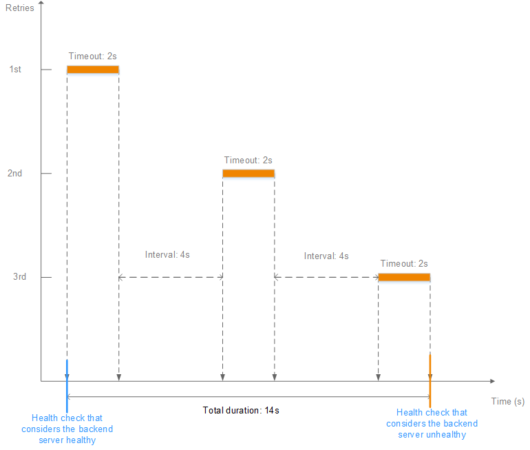

Health Check Time Window
Health checks greatly improve service availability. However, if health checks are too frequent, service availability will be compromised. To avoid the impact, ELB declares a backend server healthy or unhealthy after several consecutive health checks.
The health check time window is determined by the factors in Table 2.
Table 2 Factors affecting the health check time window
Factor
Description
Check Interval
How often health checks are performed.
Timeout Duration
How long the load balancer waits for the response from the backend server.
Health Check Threshold
The number of consecutive successful or failed health checks required for determining whether the backend server is healthy or unhealthy.
The following is a formula for you to calculate the health check time window:
  • Time window for a backend server to be detected healthy = Timeout duration × Healthy threshold + Interval × (Healthy threshold – 1)
  • Time window for a backend server to be detected unhealthy = Timeout duration × Unhealthy threshold + Interval × (Unhealthy threshold – 1)
As shown in Figure 4, if the health check interval is 4s, the health check timeout duration is 2s, and unhealthy threshold is 3, the time window for a backend server to be considered unhealthy is calculated as follows: 2 × 3 + 4 × (3 – 1) = 14s.
Figure 4 Health check time window
