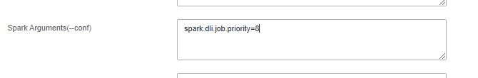

Enter the following statement in the Spark Arguments(--conf) text box, where x indicates the priority value:
spark.dli.job.priority=x

- Select the job for which you want to set the priority and click Edit in the Operation column.
- Set the spark.dli.job.priority parameter in the Spark Arguments(--conf) text box. Figure 1 Example configuration for a Spark job
