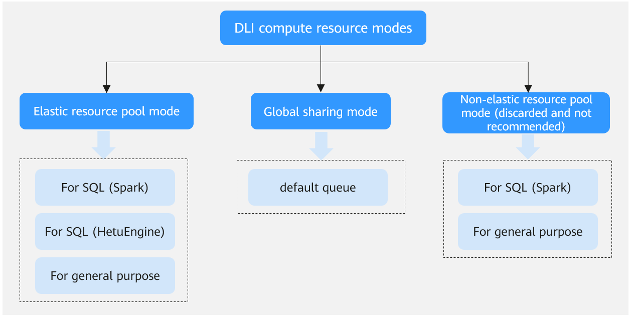

DLI Compute Resource Modes
DLI offers three compute resource management modes, each with unique advantages and use cases.
- Elastic resource pool mode: A pooled management mode for compute resources that provides dynamic scaling capabilities. Queues within the same elastic resource pool share compute resources. By setting up a reasonable compute resource allocation policy for queues, you can improve compute resource utilization and meet resource demands during peak hours.
- Use cases: suitable for scenarios with significant fluctuations in business volume, such as periodic data batch processing tasks or real-time data processing needs.
- Supported queue types: for SQL (Spark), for SQL (HetuEngine), and for general purpose. For details about DLI queue types, see Queue Types.
General-purpose queues and SQL queues in elastic resource pool mode do not support cross-AZ deployment.
- Usage: first create an elastic resource pool, then create queues within the pool and allocate compute resources. Queues are associated with specific jobs and data processing tasks.
For how to buy an elastic resource pool and create queues within it, see Creating an Elastic Resource Pool and Creating Queues Within It.
- Global sharing mode:
Global sharing mode is a compute resource allocation mode that allocates resources based on the actual amount of data scanned in SQL queries. It does not support specifying or reserving compute resources.
The default queue, which is preset by DLI, is the compute resource for global sharing mode, and the resource size is allocated on demand. Users who are unsure of the data size or occasionally need to process data can use the default queue to run jobs.
- Use cases: suitable for testing jobs or scenarios with low resource consumption.
- Supported queue types: Only the preset default queue in DLI is the compute resource for global sharing mode.
The default queue is typically used by users who are new to DLI but it may lead to resource contention and prevent you from getting the resources you need for your jobs, as its resources are shared among all users. You are advised to use self-built queues to run production jobs.
- Usage: The default queue is only applicable to submitting SQL jobs. When submitting SQL jobs on the DLI management console, select the default queue.
- Non-elastic resource pool mode (deprecated and not recommended):
The previous-gen of DLI's compute resource management mode is no longer recommended due to its lack of flexibility.
Non-elastic resource pool mode provides fixed-specification compute resources that are purchased and exclusively used, and cannot be dynamically adjusted according to demand, which may result in resource waste or insufficient resources during peak hours.

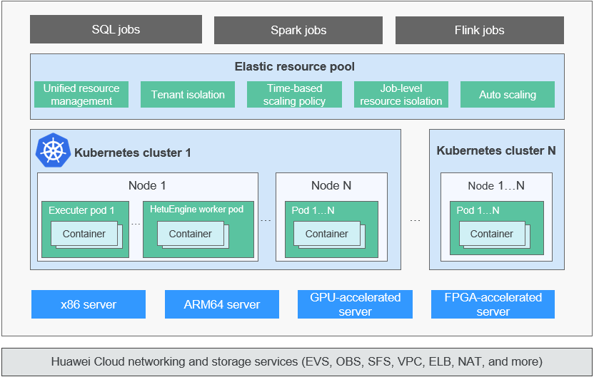

Advantages of Elastic Resource Pools
Figure 2 shows the architecture of an elastic resource pool. Elastic resource pools have the following advantages:
- Unified resource management
You can manage multiple internal clusters and schedule jobs in a unified manner. The scale of compute resources can reach million vCPUs.
- Tenant resource isolation
Resources of different queues are isolated to reduce the impact on each other.
- Time-based on-demand elasticity
- Minute-level scaling to cope with traffic peaks and resource requirements.
- You can queue priorities and CU quotas at different times to improve resource utilization.
- Job-level resource isolation (not implemented currently and will be supported in later versions)
You can run SQL jobs on independent Spark instances, reducing mutual impacts between jobs.
- Automatic scaling (not implemented currently and will be supported in later versions)
Queue quotas are automatically updated in real time based on queue loads and priorities.
