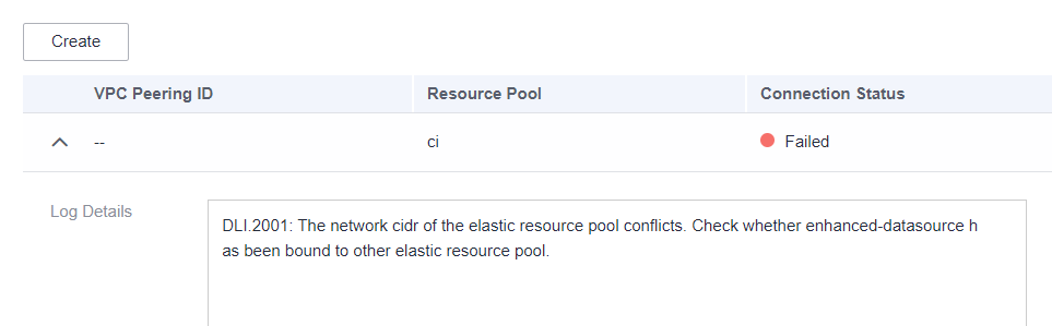

- Status of the VPC peering connection:
The status of a datasource connection can be Creating, Active, or Failed.
If the connection status is Failed, click
on the left to view the detailed error information.Figure 1 Viewing details
