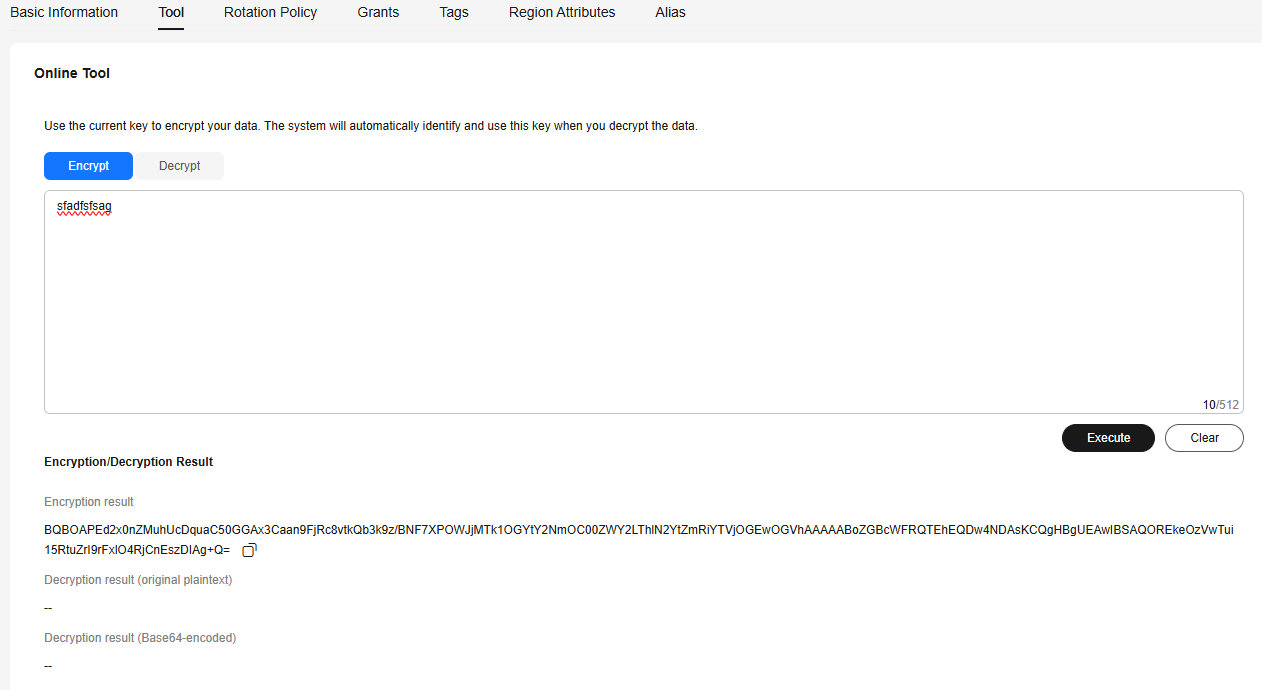

- Click Encrypt. In the text box on the left, enter the data to be encrypted, as shown in Figure 1.
- Click Execute. The encrypted data is displayed in the Encryption/Decryption Result area.
- Use the current CMK to encrypt the data.
- To clear your input, click Clear.
- In the Encryption result area, click
to copy the encrypted data and save it to a local file.
