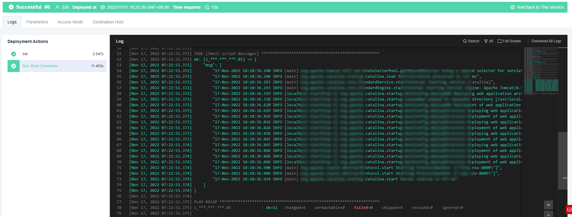

  1. Run the tail command to query the service startup or execution logs.
  2. Run the following command to query the last 20 lines of the log. The following figure shows the command output.
    tail -n 20 /usr/local/tomcat/apache-tomcat-8.5.38/logs/catalina.out
Do not run the cat command when running the shell command to view files. If the log file is too large, it may take some time to load data. Do not use the tail –f command.
