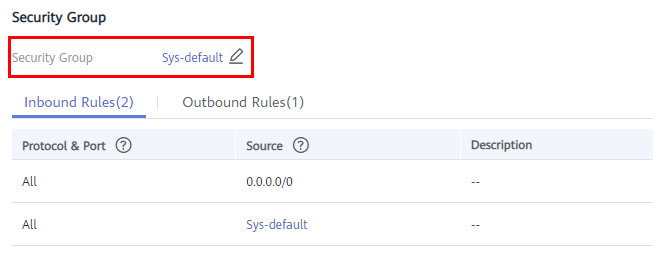

- In the Security Group area, click
to select the security group to which the DB instance belongs. Figure 1 Changing a security group
- To submit the change, click
. This process takes about 1 to 3 minutes. - To cancel the change, click
- View the modification result.
