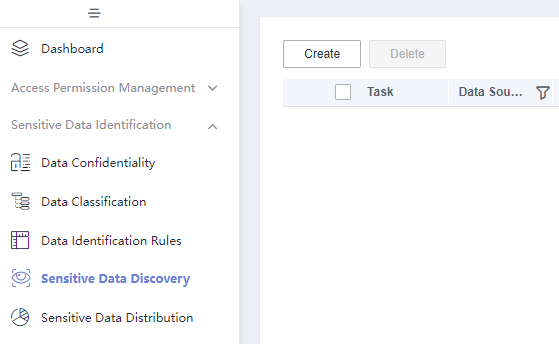

- On the DataArts Studio console, locate a workspace and click DataArts Security.
- Choose from the left navigation bar.
Figure 1 Sensitive Data Discovery page

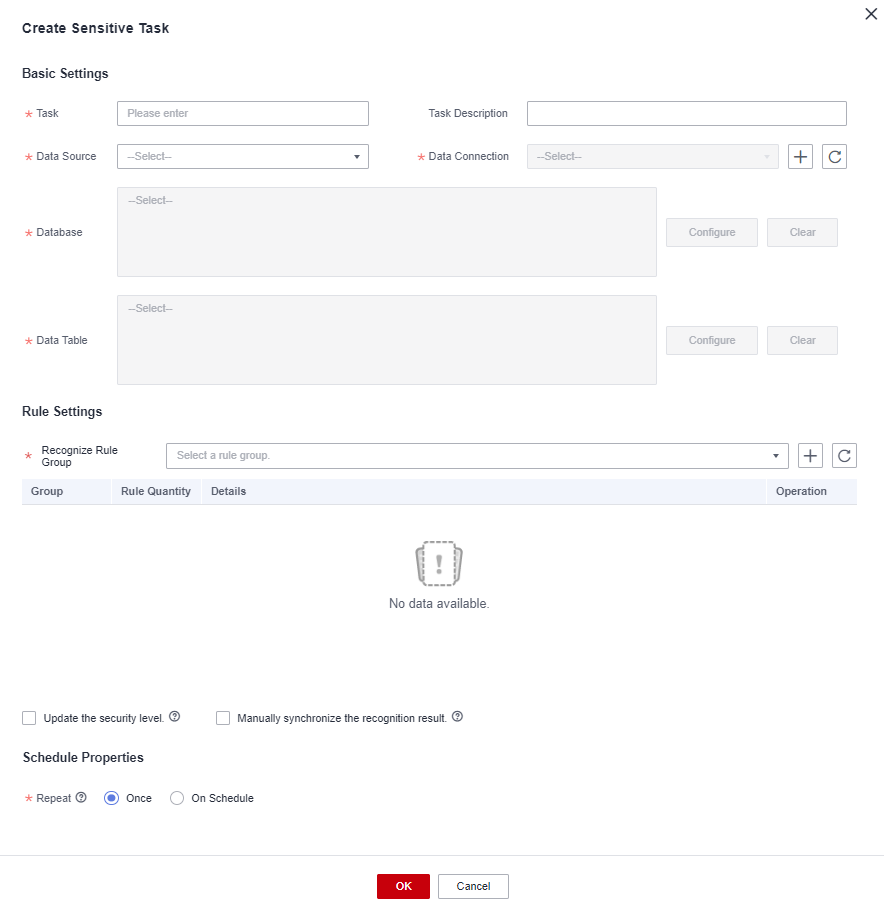

- Click Create. In the Create Sensitive Task slide-out panel, set parameters based on Table 1.
Figure 2 Setting parameters for the sensitive data discovery task
The following table lists the parameters for a sensitive data discovery task.Table 1 Parameters Parameter
Description
Basic Settings
*Task
Name of the task. To facilitate task management, you are advised to include the data table to be identified and the rule group to be used in the task name.
Task Description
A description of the task to be created.
*Data Source
Select a created data source from the drop-down list.
*Data Connection
Select a data connection from the drop-down list.
If no data connection is available, create one by referring to Creating a DataArts Studio Data Connection.
*Database
Databases to be scanned. Click Configure following the Database box to select databases. Click Clear to delete the selected databases.
*Data Table
- For sensitive DLI andGaussDB(DWS) data discovery tasks, you need to select one of the following table selection modes:
- Manual: Select the tables in which you want to discover sensitive data. You can perform fuzzy match in the search box in the table filtering window. If you want to select all tables, you need to select them page by page.
This mode is recommended if you want to discover sensitive data in a small number of tables.
- Wildcard: Enter matching rules to match target tables based on wildcards. You can enter a maximum of 100 matching rules for a task and separate them by line breaks. Each line is regarded as a rule. A rule can contain only letters, digits, underscores (_), and wildcards (*).
For example, the test_* rule means to match tables whose names start with test_. You can also check whether the matching rules meet expectations in the test window.
This mode is recommended if there are a large number of rules and tables.
- All: You do not need to enter rules or filter tables. All tables will be scanned.
Select this mode if you want to scan all tables in the selected databases.
- For sensitive MRS Hive data discovery tasks, only the Manual mode is available. You can perform fuzzy match in the search box in the table filtering window. If you want to select all tables, you need to select them page by page.
Sampling
This parameter is available when Data Source is DWS. The maximum value allowed is 10,000.
*Computing Queue
This parameter is mandatory if Data Source is set to DLI. Select a general-purpose DLI queue for executing DLI jobs.
NOTE:General-purpose queues whose Spark version is 3.3.1 are not supported.
Rule Settings
*Recognize Rule Group
Select a rule group from the drop-down list. If no rule groups are created, create one by referring to Creating Identification Rule Groups.
When you select a group, details about the identification rules in the group are displayed. You can configure thresholds for preset rules and custom rules that contain content matching. When the proportion of the number of records that match the identification rule of a field to the total number of records in the data table exceeds the threshold (80% by default), the field is considered sensitive. If different rule groups contain the same rule, the threshold for the rule must be the same.
Manually synchronize the recognition result
Only the DAYU Administrator, Tenant Administrator, or data security administrator has the permission to enable automatic synchronization of sensitive data to Data Map or manually synchronize sensitive data to Data Map.- Automatic synchronization: If Manually synchronize the recognition result is not selected during the creation of a sensitive data discovery task, sensitive data is automatically synchronized to Data Map.
- Manual synchronization: If you select Manually synchronize the recognition result when creating a sensitive data discovery task, you need to choose Sensitive Data Distribution and click the Manual Recovery tab to synchronize sensitive data to Data Map.
When creating a sensitive data discovery task as a common user other than the DAYU Administrator, Tenant Administrator, or data security administrator, you must select Manually synchronize the recognition result so that the task can be successfully created. In addition, if you run or schedule a task for which Manually synchronize the recognition result is not selected as a common user, the task cannot be executed.
Schedule Properties
Once
The sensitive data discovery task runs only once.
On Schedule
The sensitive data discovery task runs based on the configured scheduling period.
- Date
Period during which the task takes effect
- Cycle
The frequency at which a task is executed. The options are:
- minutes: Select the scheduling start time and end time, and set the interval in minutes.
- hours: Select the scheduling start time and end time, and set the interval in hours.
- Day: Set the scheduling time everyday.
- Week: Select a day in a week and set the specific time to start scheduling.
- Month: Select a day in a month and set the specific time to start scheduling.
For example, you can set Cycle to Week, Time to 15:52, and Time Range to Tuesday. In this case, the task is executed at 15:52 every Tuesday within the configured date range.
- Start now: If you select this option, the task is scheduled immediately.
Configure Resources
Specifications
If DLI Spark resources are sufficient, you can configure Spark task resources to accelerate the execution of the sensitive data discovery task.
The system provides three types of resource flavors. The default flavor is A. You can choose a flavor that meets your requirements.
NOTE:If more resources than available ones are requested, the task may fail.
- A (8 vCPUs, 32 GB memory; executor memory: 4 GB; number of executors: 6; number of executor CPUs: 1; number of driver CPUs: 2; driver memory: 7 GB)
- B (16 vCPUs, 64 GB memory; executor memory: 8 GB; number of executors: 7; number of executor CPUs: 2; number of driver CPUs: 2; driver memory: 7 GB)
- C (32 vCPUs, 128 GB memory; executor memory: 8 GB; number of executors: 14; number of executor CPUs: 2; number of driver CPUs: 4; driver memory: 15 GB)
NOTE:The parallelism degree of Spark resources is jointly determined by the number of Executors and the number of Executor CPU cores. The maximum number of tasks that can be concurrently executed is equal to the number of executors multiplied by the number of executor CPUs. You can properly plan compute resource specifications based on the DLI queue resources.
Note that Spark tasks need to be jointly executed by multiple roles, such as driver and executor. So, the number of executors multiplied by the number of executor CPU cores must be less than the number of compute CUs of the queue to prevent other roles from failing to start Spark tasks.
Calculation formula for Spark job parameters:
- CUs = Driver Cores + Executors x Executor Cores
- Memory = Driver Memory + (Executors x Executor Memory)
Executor Memory
Memory of each Executor. It is recommended that the ratio of Executor CPU cores to Executor memory be 1:4.
The value ranges from 0 to 16 GB or from 0 to 16,384 MB. If more resources than available ones are requested, the task may fail.
Executor Cores
Number of CPU cores of each Executor applied for by jobs, which determines the capability of each Executor to execute tasks concurrently.
Enter a value from 0 to 4. If more resources than available ones are requested, the task may fail.
Executors
Number of Executors applied for by a job Enter a value from 0 to 100. If more resources than available ones are requested, the task may fail.
Driver Cores
Number of CPU cores of the driver Enter a value from 0 to 4. If more resources than available ones are requested, the task may fail.
Driver Memory
Driver memory size. It is recommended that the ratio of the number of driver CPU cores to the driver memory be 1:4. The value ranges from 0 to 16 GB or from 0 to 16,384 MB. If more resources than available ones are requested, the task may fail.
- Click OK. The sensitive data discovery task is created.
