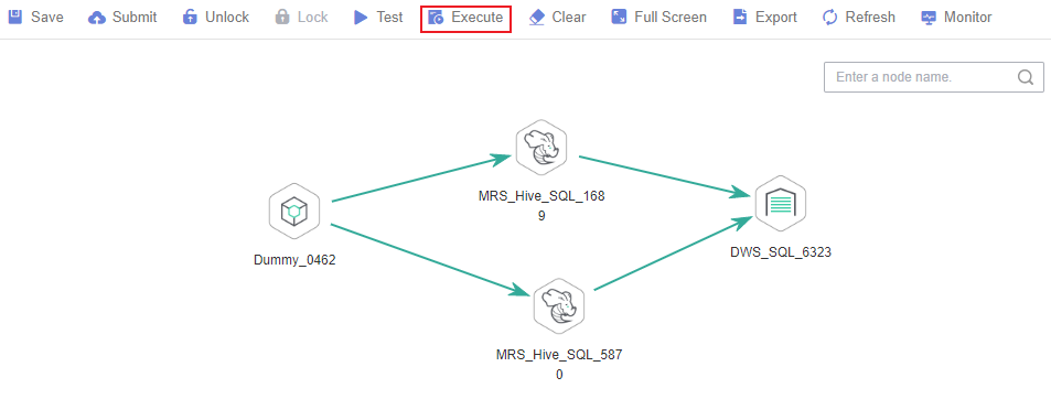

- In the navigation pane, click
and double-click the job for which lineages have been configured to open it. - Click Execute. The system starts parsing lineages of the job.
If you click Test, the system will not parse lineages of the job.
Figure 1 Starting job scheduling
- After the job is successfully executed, wait for about 1 minute. The data lineage is generated.

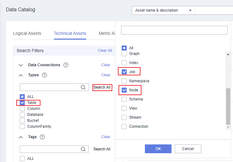

- In the navigation pane, choose Data Catalog. In the right pane, click the Technical Assets tab. On this page, you can query jobs, nodes, and tables.
In the Types area, click Search All, select Job, Node, and Table, and click OK.
Jobs do not belong to any data connection. If you select a data connection in the search filters, no result will be returned.
Figure 2 Selecting types

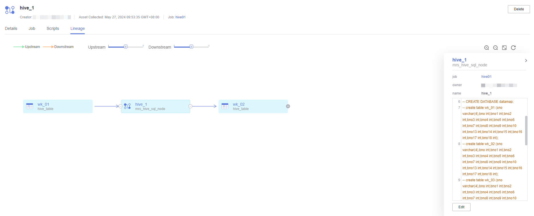

- In the data asset search result, click the name of an asset ending with _node to view its details. On the node details page, you can view the node lineage information.
- Click the + or - icon beside the node to expand its upstream and downstream links.
- Click a node to view the its details.
- Click the Job tab and then Edit to go to the job editing page.
Figure 4 Viewing lineages of a node

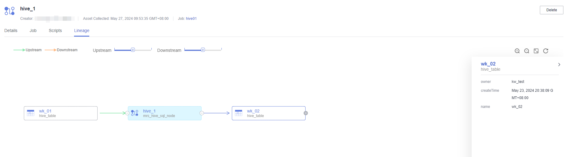

- In the data asset search result, click the name of an asset whose icon is a table to view its details. On the table details page, you can view lineages of the table.
- Click the + or - icon beside the table to expand its upstream and downstream links.
- Click a table to view its details.
Figure 5 Viewing lineages of a table
