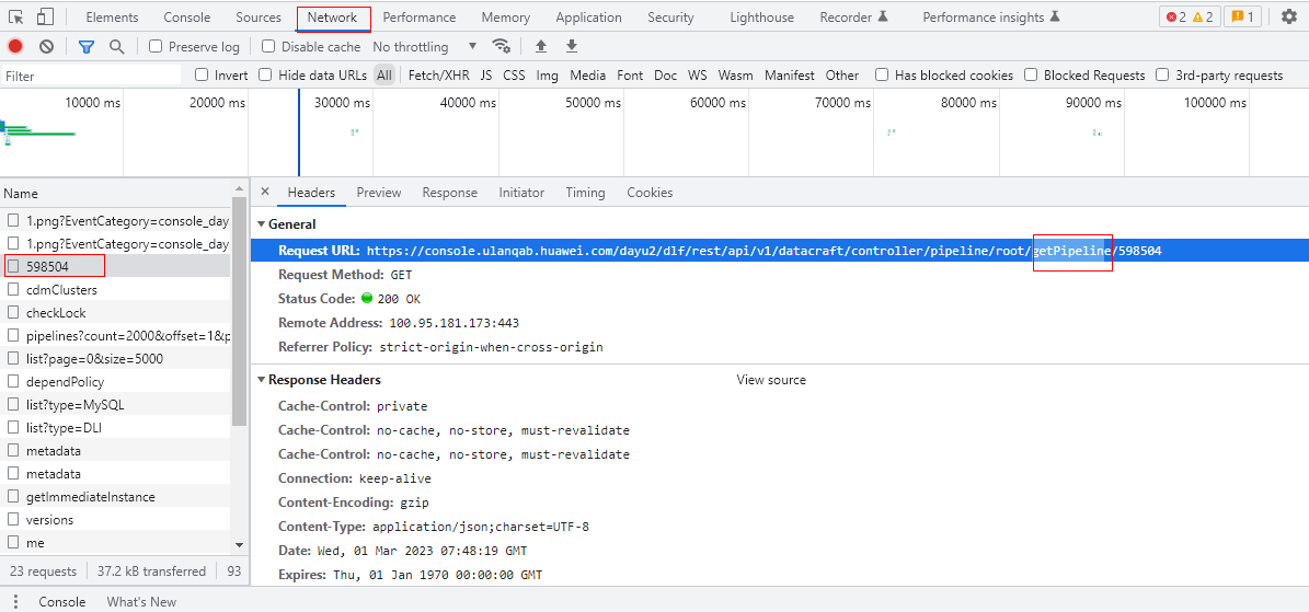

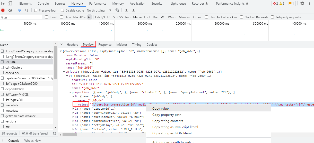

CDM Job Message Body | Yes | Enter the CDM job message body in JSON format. To obtain the JSON message body, perform the following steps:
