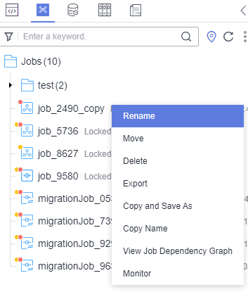

- Locate the target job in the job directory, right-click the job name, and select Copy Name to copy the job name to the clipboard. Figure 1 Copying the job name

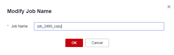

- In the job directory, select the job to be renamed. Right-click the job name and choose Rename from the shortcut menu. Figure 2 Renaming a job
- In the displayed Modify Job Name dialog box, change the job name. Figure 3 Renaming a job
Table 1 Job renaming parameters Parameter
Description
Job Name
Name of the job. Must consist of 1 to 128 characters and contain only letters, digits, hyphens (-), underscores (_), and periods (.).
- Click OK.
