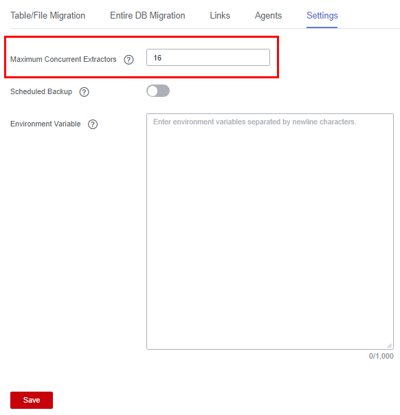

- The maximum number of concurrent extractors for a cluster varies depending on the CDM cluster flavor. You are advised to set the maximum number of concurrent extractors to twice the number of vCPUs of the CDM cluster.
Table 1 Maximum number of concurrent extractors for a CDM cluster Flavor
vCPUs/Memory
Maximum Concurrent Extractors
cdm.large
8 vCPUs, 16 GB
16
cdm.xlarge
16 vCPUs, 32 GB
32
cdm.4xlarge
64 vCPUs, 128 GB
128
Figure 1 Setting Maximum Concurrent Extractors for a CDM cluster

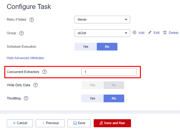

- Configure the number of concurrent extractors based on the following rules:
- When data is to be migrated to files, CDM does not support multiple concurrent tasks. In this case, set a single process to extract data.
- If each row of the table contains less than or equal to 1 MB data, data can be extracted concurrently. If each row contains more than 1 MB data, it is recommended that data be extracted in a single thread.
- Set Concurrent Extractors for a job based on Maximum Concurrent Extractors for the cluster. It is recommended that Concurrent Extractors is less than Maximum Concurrent Extractors.
- If the destination is DLI, you are advised to set the number of concurrent extractors to 1. Otherwise, data may fail to be written.
Figure 2 Setting Concurrent Extractors for a job
