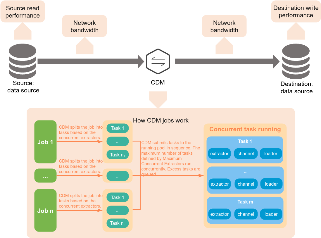

Data Migration Model
Figure 1 shows the simplified migration model used by CDM.
- When data migration jobs are submitted, CDM splits each job into multiple tasks based on the Concurrent Extractors parameter in the job configuration.
Jobs for different data sources may be split based on different dimensions. Some jobs may not be split based on the Concurrent Extractors parameter.
- CDM submits the tasks to the running pool in sequence. Tasks (defined by Maximum Concurrent Extractors) run concurrently. Excess tasks are queued.
Factors Affecting Migration Performance
According to the migration model, the migration speed is affected by factors such as the source read speed, network bandwidth, destination write performance, and CDM cluster and job configuration.
