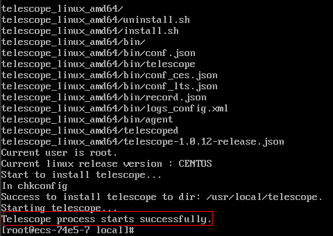

cd /usr/local && curl -k -O https://uniagent-eu-west-101.obs.eu-west-101.myhuaweicloud.eu/package/agent_install.sh && bash agent_install.sh -r eu-west-101 -u 0.2.1 -t 2.7.5 -o myhuaweicloud.eu -d agent.ces.myhuaweicloud.eu
The Agent is installed if the command output similar to the following figure is displayed.Figure 1 Successful installation - Clear the installation script.
