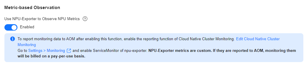

- In the Metric-based Observation area, find the Use NPU-Exporter to Observe NPU Metrics parameter, click
under it, and click OK in the lower right corner. NPU-Exporter is then deployed on the NPU nodes as a DaemonSet to observe NPU metrics. Figure 2 Enabling NPU-Exporter
- After the add-on status changes to Running, click View Details. In the window that slides out from the right, click the Pods tab. If there is an npu-exporter-xxx pod in the pod list and it is in the Running state, NPU-Exporter has been enabled.
