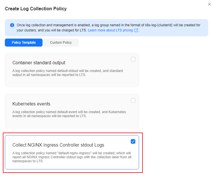

  3. In the upper right corner, click View Log Collection Policies. All log collection policies in the current cluster are displayed.
  4. Click Create Log Collection Policy. Then, select Collect NGINX Ingress Controller stdout Logs and click OK.
    Figure 1 Creating a log collection policy

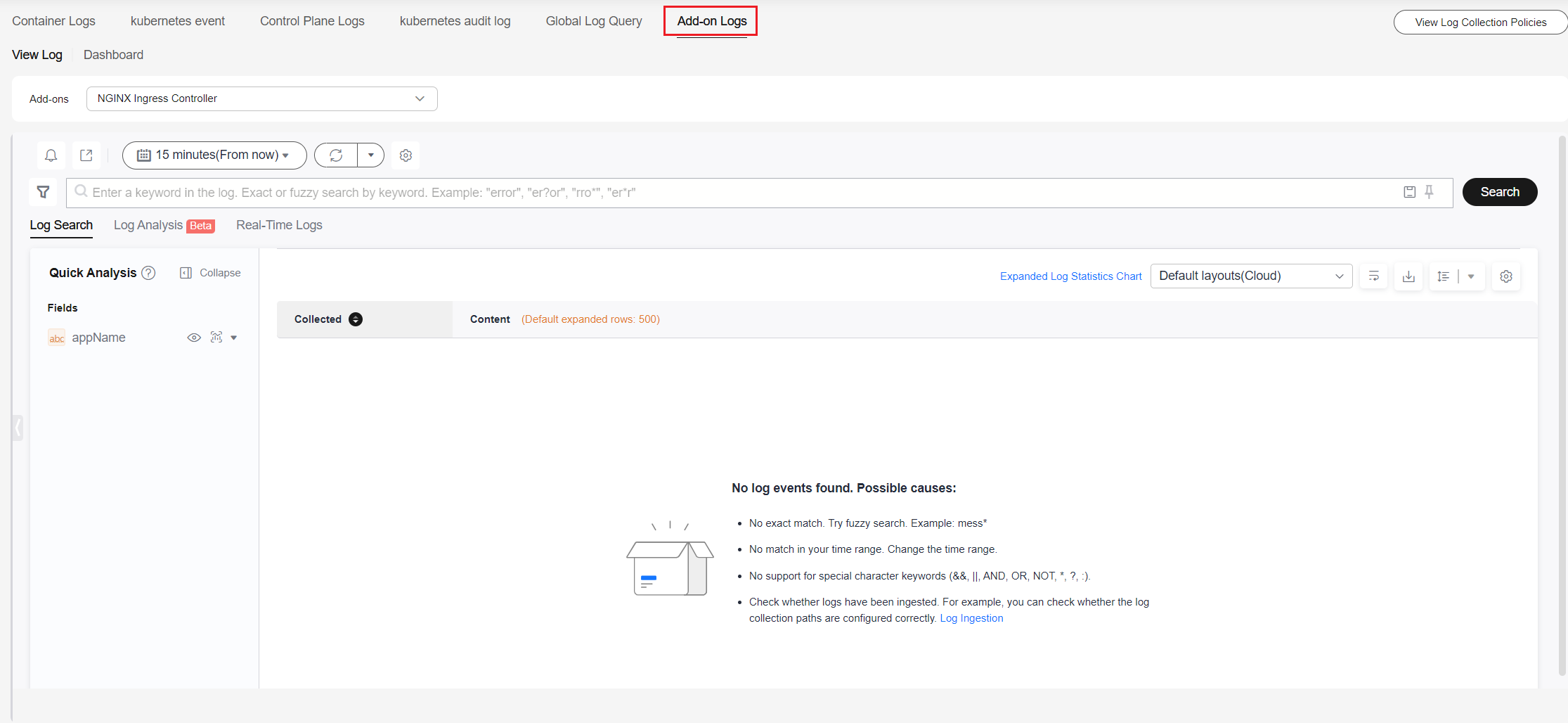

  5. (The system automatically creates a log collection policy named default-nginx-ingress.) Go to the Logging page and click the Add-on Logs tab to view the logs reported by the add-on to LTS.
    Figure 2 Viewing logs

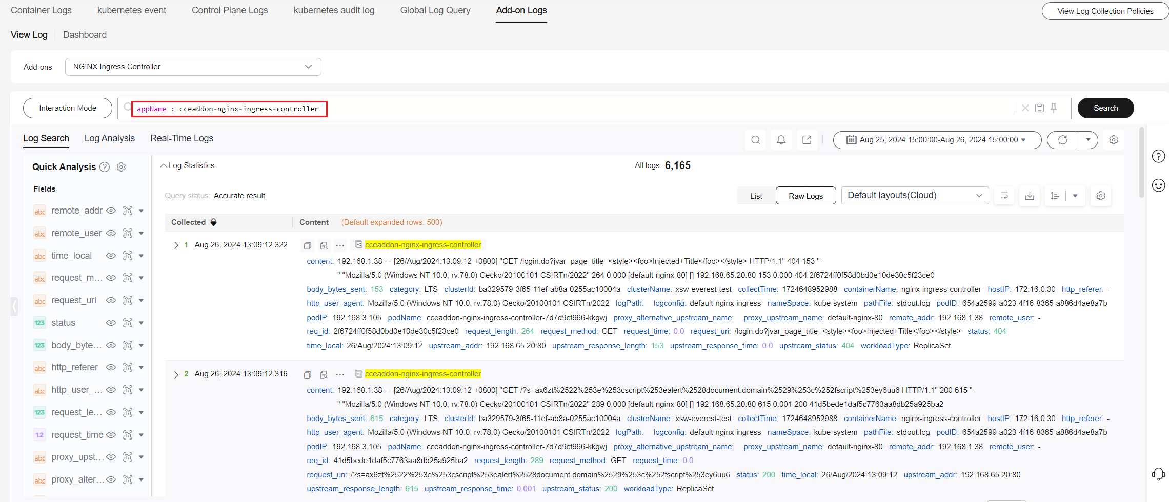

  4. (If multiple add-on instances are installed in the cluster and log collection has been enabled for these instances, logs of all instances will be displayed.) Search for logs by appName.
    The options of appName are as follows:
    • If the NGINX Ingress Controller name is nginx, the value of appName is cceaddon-nginx-ingress-controller.
    • If the NGINX Ingress Controller name is user-defined, for example, {className}, the value of appName is cceaddon-nginx-ingress-{className}-controller.
    The following are example logs of cceaddon-nginx-ingress-controller:
    appName : cceaddon-nginx-ingress-controller

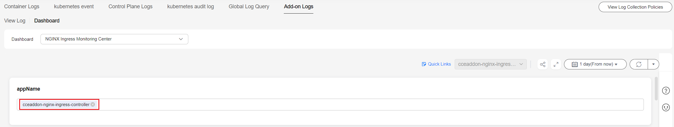

  1. Log in to the CCE console and click the cluster name to access the cluster console.
  2. In the navigation pane, choose Logging.
  3. Click the Add-on Logs tab and then the Dashboard tab. On the displayed tab, you can select different dashboard templates.

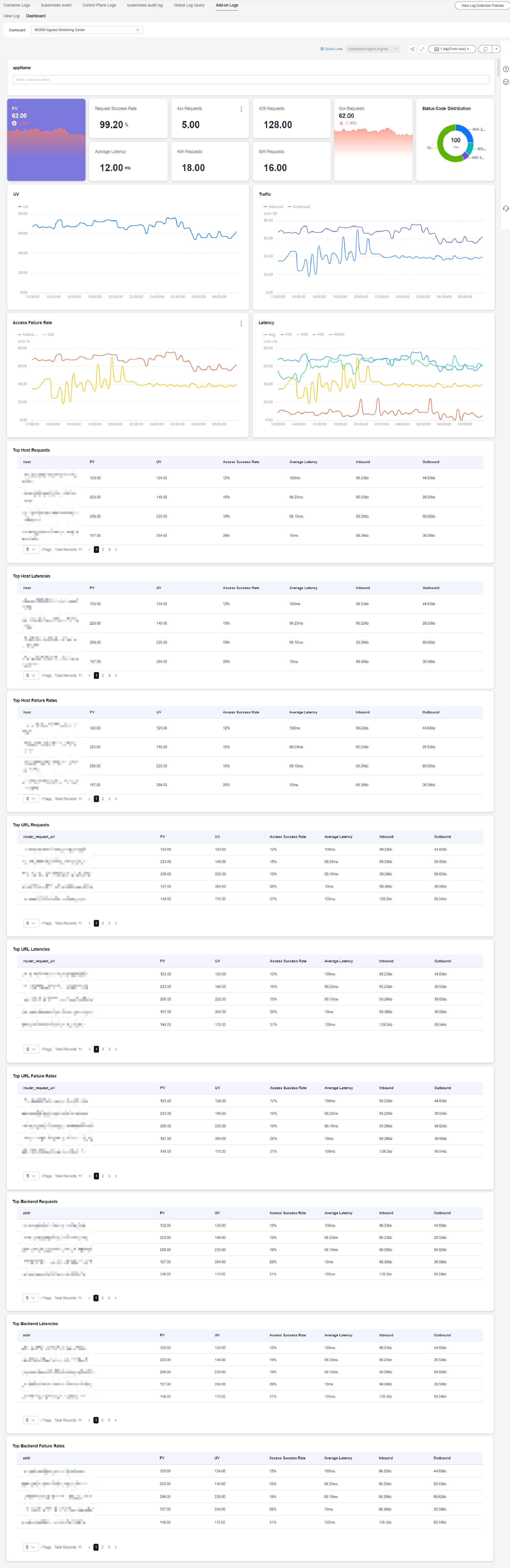

This dashboard displays basic information about NGINX Ingress in different time dimensions (relative time from now, relative time from last, and specified time), including:
  • Access data: PV, UV, request success rate, average latency, the number of 4XX requests, the number of 404 requests, the number of 429 requests, the number of 5XX requests, the number of 504 requests, status code distribution, traffic, access failure rate, and latency
  • Top statistics: hosts ranked by requests, hosts ranked by latencies, hosts ranked by failure rates, URLs ranked by requests, URLs ranked by latencies, URLs ranked by failure rates, backend severs ranked by requests, backend severs ranked by latencies, and backend severs ranked by failure rates

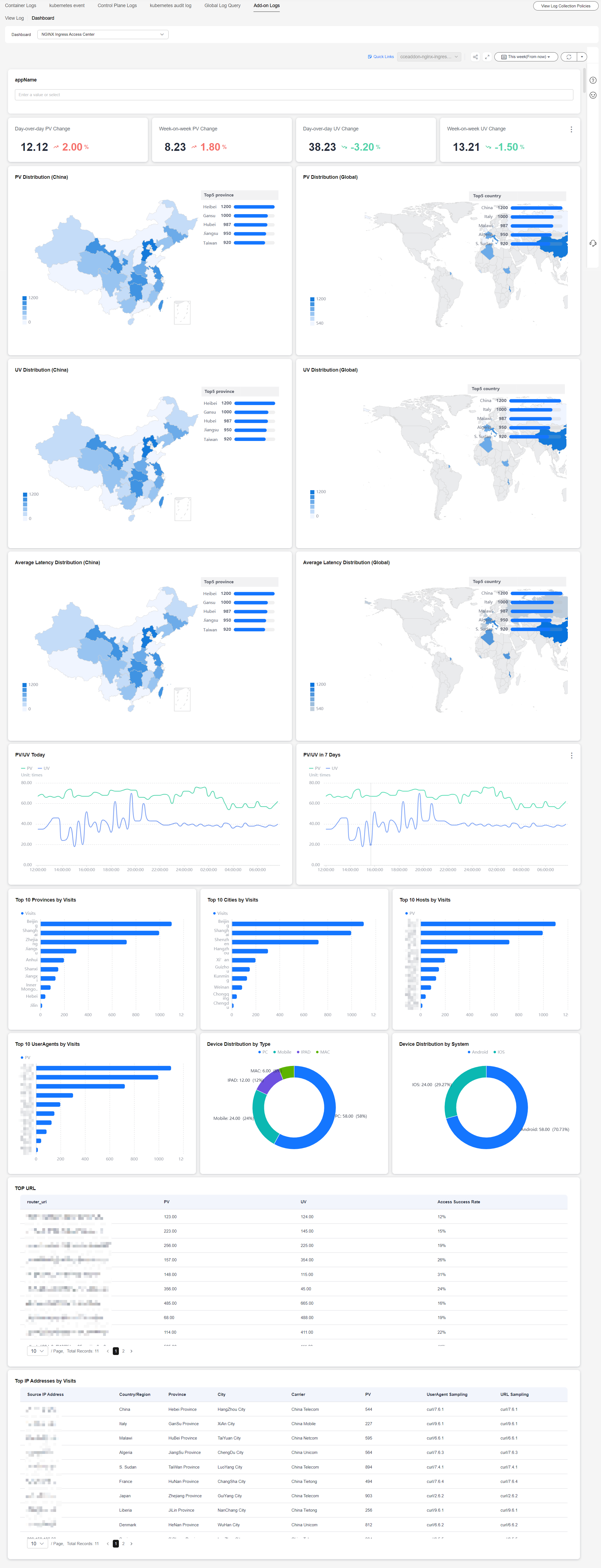

This dashboard displays access request statistics in different time dimensions (relative time from now, relative time from last, and specified time), including:
  • Data comparison: day-over-day PV, week-over-week PV, day-over-day UV, week-over-week UV, PV/UV today, and PV/UV in past seven days
  • Data distribution: PV distribution (China), PV distribution (global), UV distribution (China), UV distribution (global), average latency distribution (China), average latency distribution (global), device proportion (by terminal), and device proportion (by system)
  • Top statistics: top 10 provinces with the most requests, top 10 cities with the most requests, top 10 hosts with the most requests, top 10 UserAgents with the most requests, top URLs with the most requests, and top IP addresses with the most requests

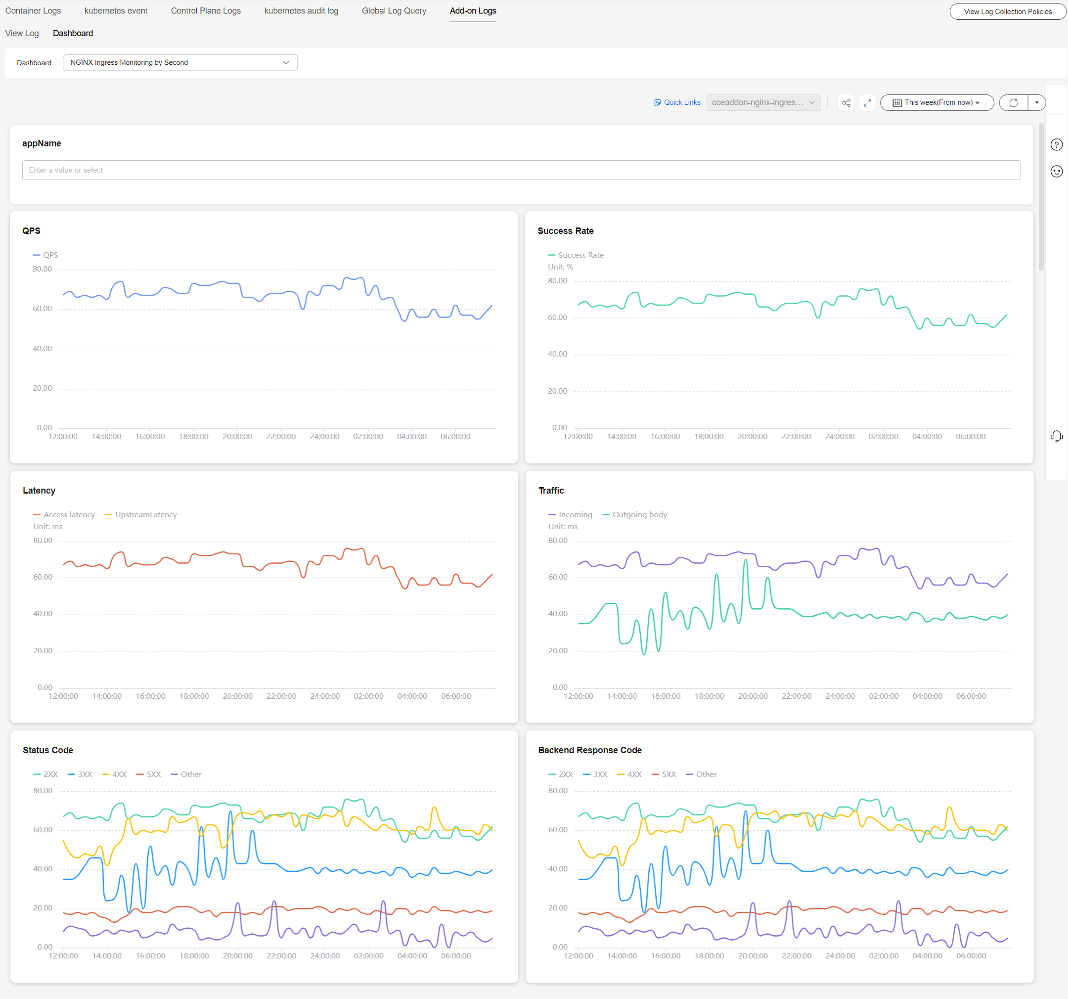

This dashboard displays NGINX Ingress traffic and application performance in real time, including QPS, success rates, latencies, traffic, status codes, and backend response codes.
