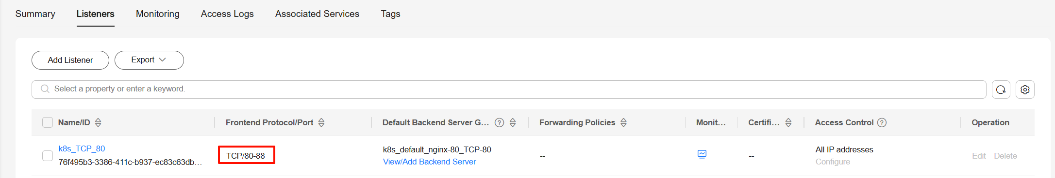

Verifying Configuration
- Log in to the CCE console and click the cluster name to access the cluster console.
- In the navigation pane, choose Services & Ingresses. Locate the row that contains the created Service and click the load balancer name to go to the ELB console.
- On the Listeners tab page, check the port number of the new listener.
