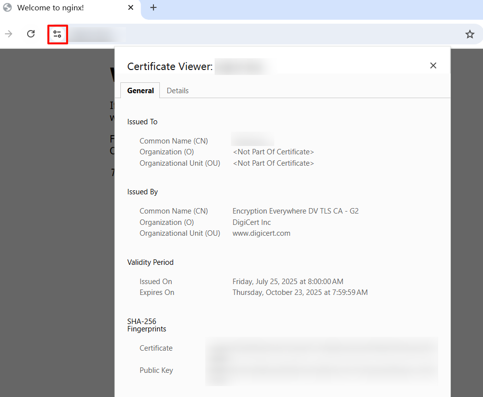

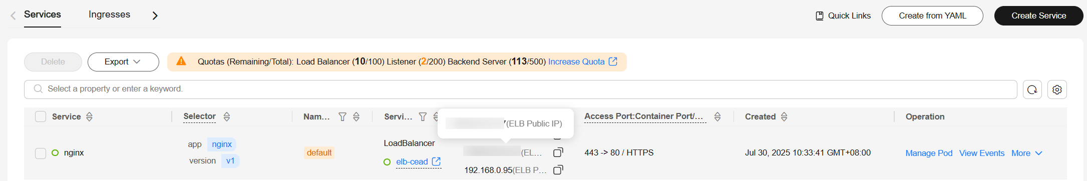

Step 3: Access the Workload
  1. After the Service is created, copy the load balancer's EIP.
  2. Configure DNS for a domain name so that you can use the SNI domain name for browser access.
  3. View the certificate details returned by the server, such as the issuer, validity period, and SHA-256 fingerprint, in the browser to ensure that the certificate corresponds to the requested SNI domain name.
