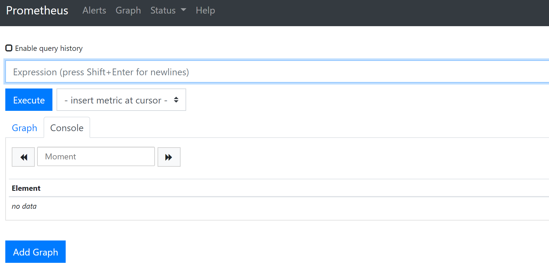

  3. After the Service is created, enter {public-IP-address-of-the-load-balancer}:{Service-port} in the address box of the browser to access Prometheus.
    Figure 1 Accessing Prometheus

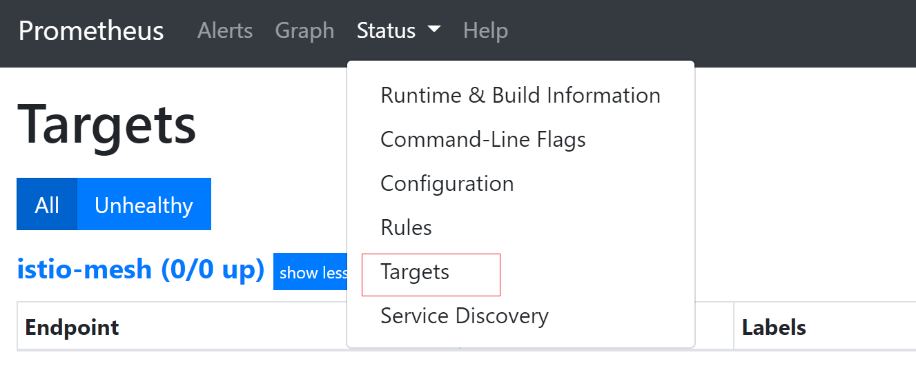

  4. Choose Status > Targets to view the targets monitored by Prometheus.
    Figure 2 Viewing monitored targets

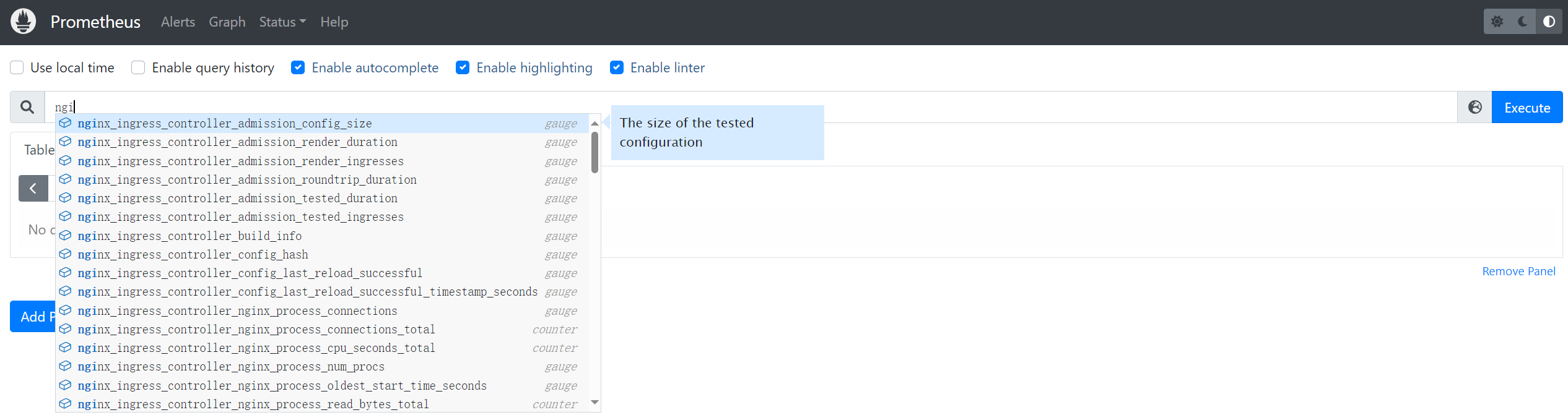

Log in to Prometheus and click Graph to view the metrics of NGINX Ingress Controller.
Figure 3 Viewing the metrics of NGINX Ingress Controller
