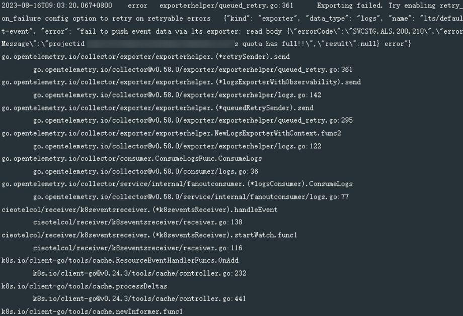

What Can I Do If Logs Cannot Be Reported and "log's quota has full" Is Displayed in stdout Logs of otel?
Solution:
LTS provides a free log quota. If the quota is used up, you will be charged for the excess log usage. If an error message is displayed, the free quota has been used up. To continue collecting logs, log in to the LTS console, choose Configuration Center in the navigation pane, and enable Continue to Collect Logs When the Free Quota Is Exceeded.

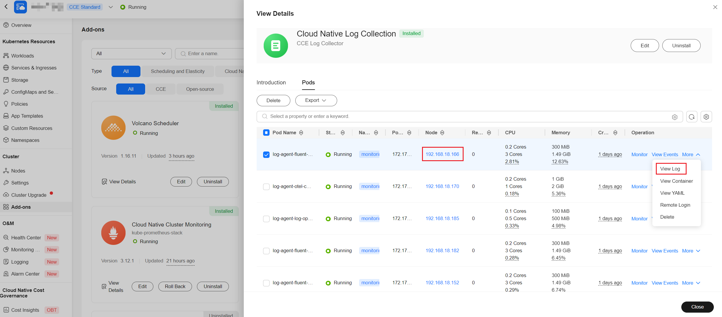

What Can I Do If the Cloud Native Log Collection Add-on Is Running Normally but Some Log Collection Policies Do Not Take Effect?
Solution:
- If the log collection policy of the event type does not take effect or the add-on version is earlier than 1.5.0, check the stdout of the log-agent-otel-collector workload.
Go to the Add-ons page and click Cloud Native Log Collection. Then, click the Pods tab, locate log-agent-otel-collector, and choose More > View Log in the Operation column.
- If the log collection policy of the other type does not take effect and the add-on version is later than 1.5.0, check the log of log-agent-fluent-bit on the node where the container to be monitored is running.
Go to the Add-ons page and click Cloud Native Log Collection. Then, click the Pods tab, locate log-agent-fluent-bit, and choose More > View Log in the Operation column.
Select the fluent-bit container, search for the keyword "fail to push {event/log} data via lts exporter" in the log, and view the error message.
- If the error message "The log streamId does not exist." is displayed, the log group or log stream does not exist. In this case, choose Logging > View Log Policy, edit or delete the log collection policy, and recreate a log collection policy to update the log group or log stream.
- For other errors, go to LTS to search for the error code and view the cause.

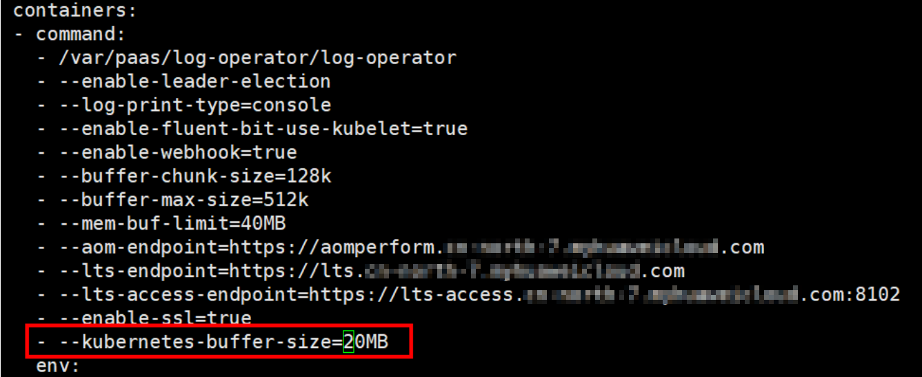

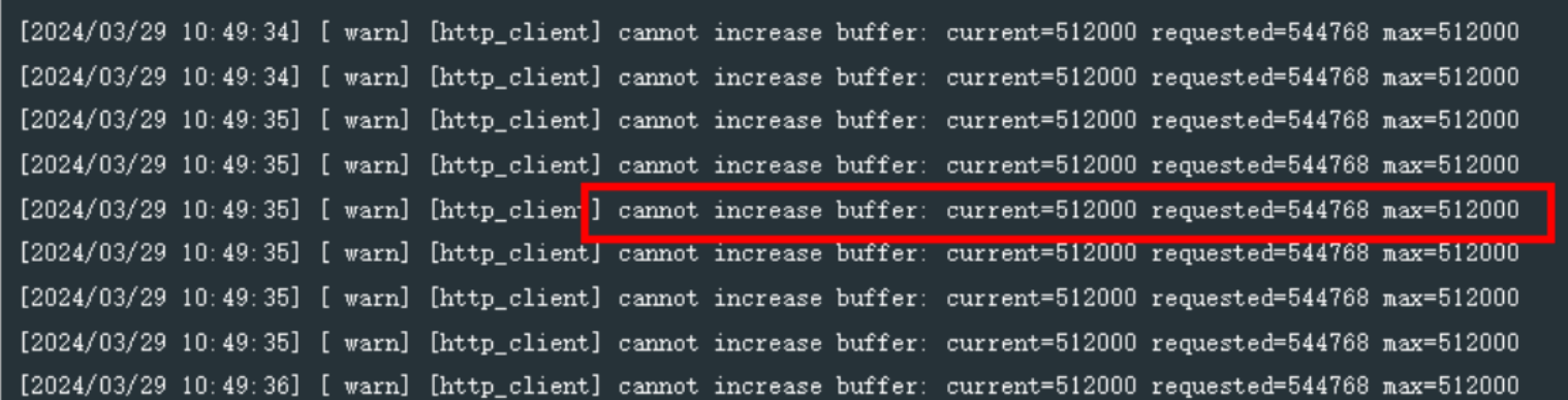

What Can I Do If Some Pod Information Is Missing During Log Collection Due to Excessive Node Load?
When the Cloud Native Log Collection add-on version is later than 1.5.0, some pod information, such as the pod ID and name, is missing from container file logs or stdout logs.
Troubleshooting:
Select the fluent-bit container and search for the keyword "cannot increase buffer: current=512000 requested=*** max=512000" in the log.
Solution:
Run the kubectl edit deploy -n monitoring log-agent-log-operator command on the node and add --kubernetes-buffer-size=20MB to the command lines of the log-operator container. The default value is 16MB. You can estimate the value based on the total size of pod information on the node. 0 indicates no limits.
If the Cloud Native Log Collection add-on is upgraded, you need to reconfigure kubernetes-buffer-size.

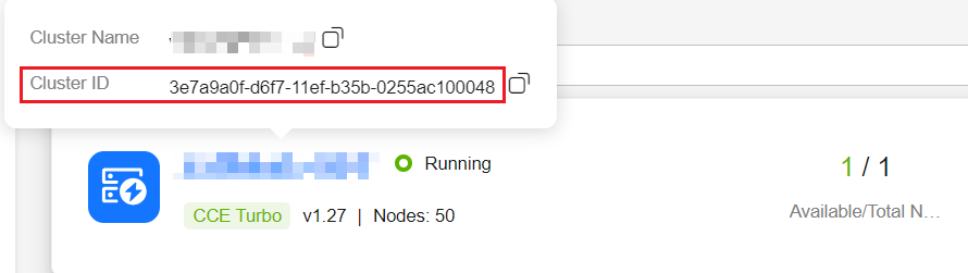

How Do I Change the Log Storage Period on Logging?
- Log in to the CCE console and choose Clusters. On the displayed page, hover the cursor over the cluster name to view the current cluster ID. Figure 8 Viewing the cluster ID
- Log in to the LTS console. Then, query the log group and log stream by cluster ID.
- Locate the log group and click Modify to configure the log storage period.
The log retention period affects log storage expenditures.

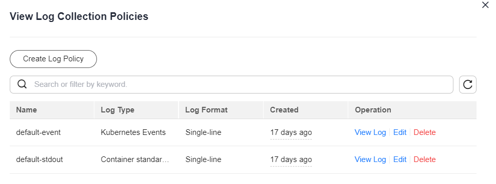

- Scenario 2: The default log group or stream exists but is inconsistent with that specified in the log collection policy.
- The log collection policy, for example, default-stdout, can be modified as follows:
- Log in to the CCE console and click the cluster name to access the cluster console. In the navigation pane, choose Logging.
- In the upper right corner, click View Log Policy. Then, locate the log collection policy and click Edit in the Operation column.
- Select Custom log group/log stream and configure the default log group or stream.
- If a log collection policy cannot be modified, for example, default-event, you need to re-create a log collection policy as follows:
- In the upper right corner, click View Log Policy. Then, locate the log collection policy and click Delete in the Operation column.
- Click Create Log Collection Policy. Then, select Kubernetes events in Policy Template and click OK.
