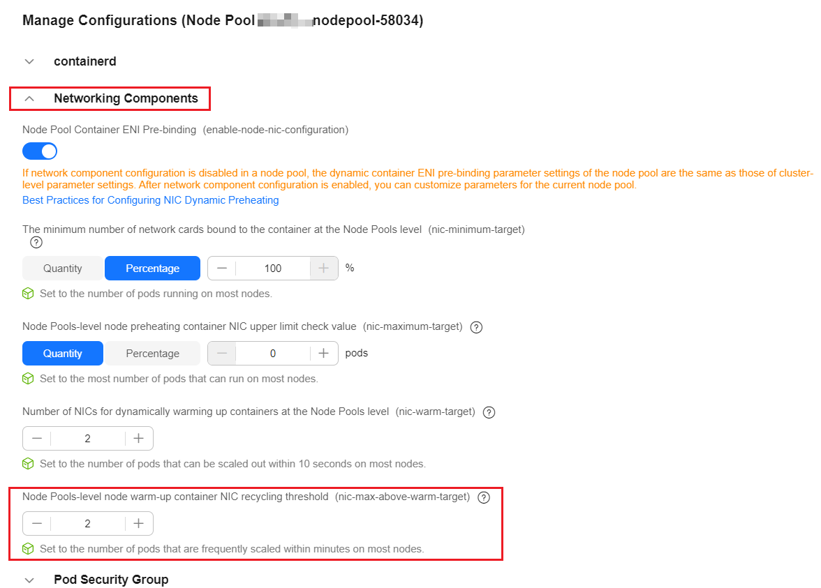

Scenario 1: Abnormal node pool configuration
To fix this issue, perform the following operations:
- Log in to the CCE console and click the cluster name to access the cluster console. In the navigation pane, choose Nodes.
- Locate the affected node pool and choose More > Manage.
- In Networking Components, set the nic-max-above-warm-target value to a maximum of 256.
- Click OK.

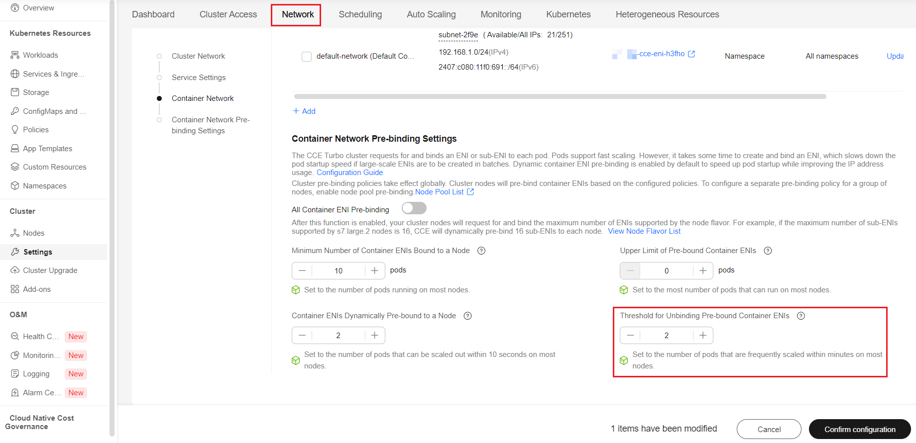

Scenario 2: Abnormal cluster configuration
- Log in to the CCE console and click the cluster name to access the cluster console. In the navigation pane, choose Settings.
- Click the Network tab and set the Threshold for Unbinding Pre-bound Container ENIs value to a maximum of 256.
- Click Confirm Configuration.
