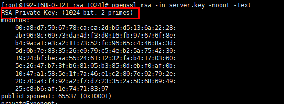

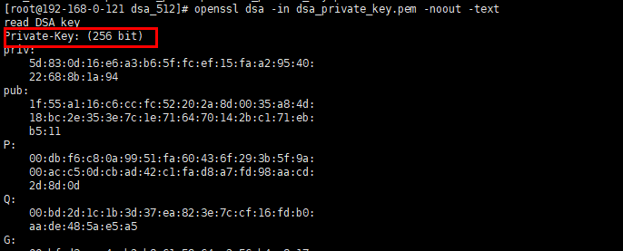

kubectl get secret <secret-name> -n <namespace> -o=custom-columns=:'data.tls\.key' | base64 -d | openssl <encryption-algorithm> -noout -text
<encryption-algorithm> is the encryption algorithm used by the certificate. Common encryption algorithms include RSA and DSA.
Method of obtaining an RSA key length
Method of obtaining a DSA key length
