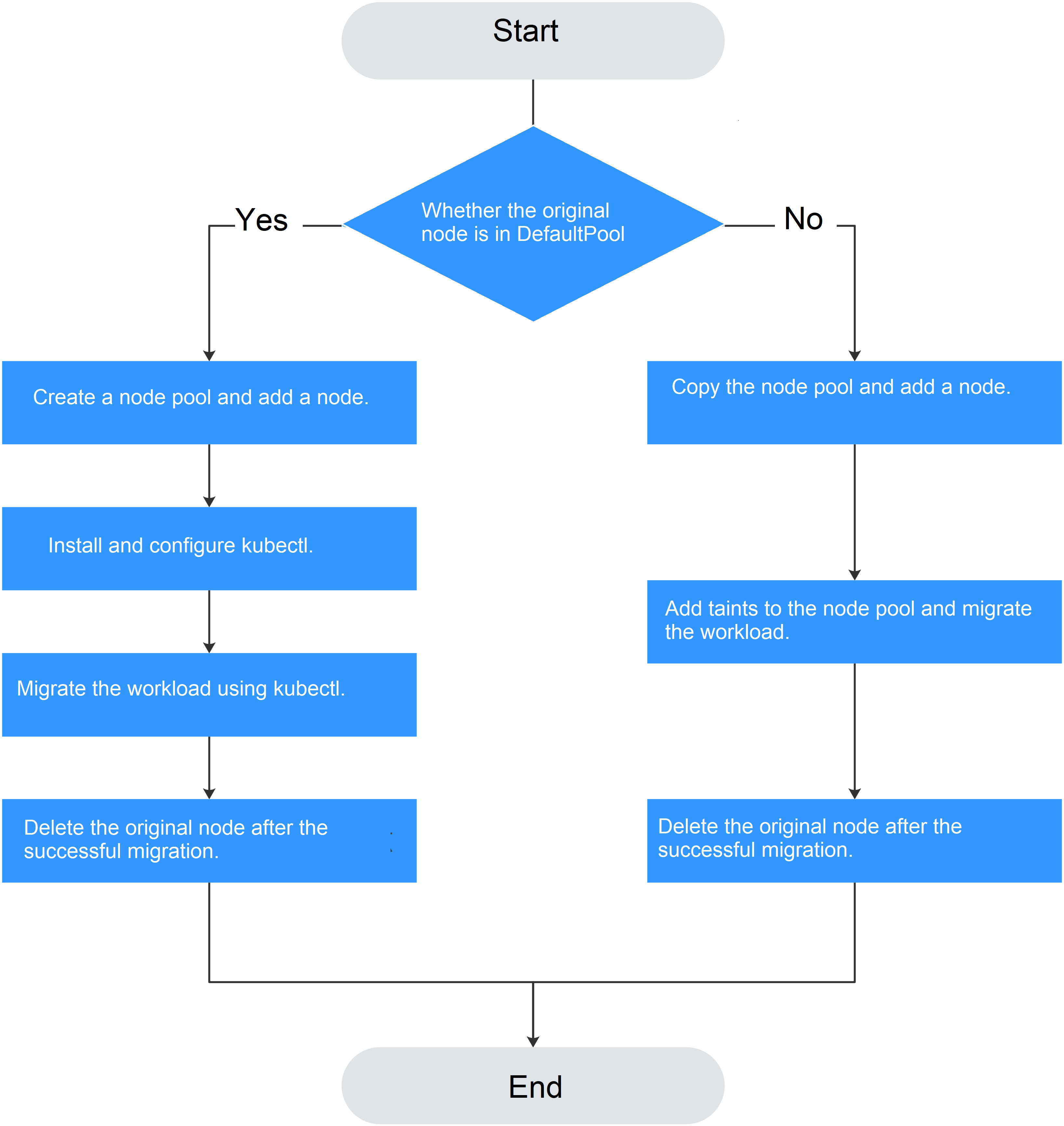

Scenario
In a rolling upgrade, a new node is created, existing workloads are migrated to the new node, and then the old node is deleted. Figure 1 shows the migration process.
Figure 1 Workload migration

Procedure If the Original Node Is in the Default Pool
  1. Create a node pool. For details, see Creating a Node Pool.
  2. On the node pool list page, click View Node in the Operation column of the target node pool. The IP address of the new node is displayed in the node list.

  1. Migrate the workload.
    1. Add a taint to the node where the workload needs to be migrated out.
      kubectl taint node [node] key=value:[effect]
      In the preceding command, [node] indicates the IP address of the node where the workload to be migrated is located. The value of [effect] can be NoSchedule, PreferNoSchedule, or NoExecute. In this example, set this parameter to NoSchedule.

Procedure If the Original Node Is Not in the Default Pool
  1. Copy the node pool and add nodes to it. For details, see Copying a Node Pool.
  2. Click View Node in the Operation column of the node pool. The IP address of the new node is displayed in the node list.
    1. Click Edit on the right of original node pool and configure Taints.
    2. Enter the key and value of a taint. The options of Effect are NoSchedule, PreferNoSchedule, and NoExecute. Select NoExecute and click Add.

  1. Delete the original node.
    After the workload is successfully migrated and runs properly, delete the original node.
