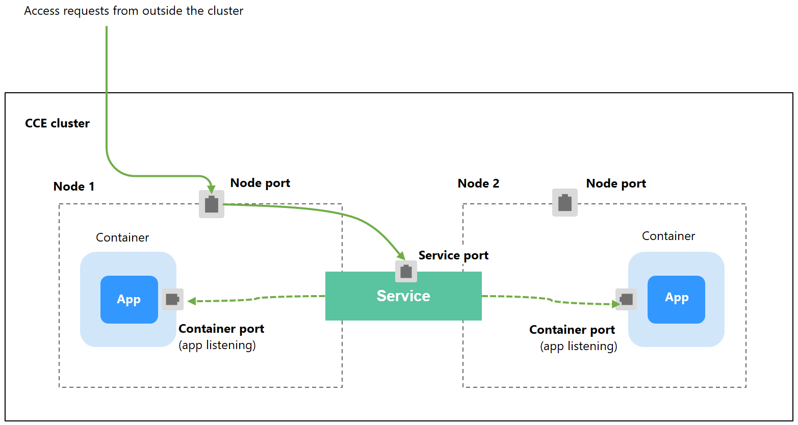

NodePort
NodePort is a basic Service type in Kubernetes. It adds node port mapping to intra-cluster access. This means the Service is exposed on each node's IP address at a static port. When you create a NodePort Service, Kubernetes automatically allocates a cluster-scoped IP address (ClusterIP). When clients outside the cluster access <node-IP>:<node-port>, the traffic will be forwarded to the target pod through the ClusterIP of the NodePort Service.
If pods require temporary access or the traffic is low, you can create a NodePort Service. For example, in a testing environment, you can use a NodePort Service when deploying and debugging a web application.

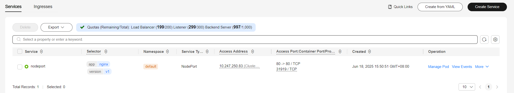

Creating a NodePort Service
- Log in to the CCE console and click the cluster name to access the cluster console.
- In the navigation pane, choose Services & Ingresses. In the upper right corner, click Create Service.
- Configure the parameters.
Parameter
Description
Service Name
Enter a name, which be can be the same as the workload name.
Service Type
Select NodePort.
Namespace
Select the namespace that the workload belongs to.
Service Affinity
Whether to route external traffic to a local node or a cluster-wide endpoint. For details, see Service Affinity (externalTrafficPolicy).- Cluster-level: The IP addresses and ports of all nodes in a cluster can access the workload associated with the Service. However, accessing the Service may result in a performance decrease due to route redirection, and the client's source IP address may not be obtainable.
- Node-level: Only the IP address and port of the node where the workload is located can access the workload associated with the Service. Accessing the Service will not result in a performance decrease due to route redirection, and the client's source IP address can be obtained.
Selector
The Service will be associated with the workload pods based on the label and direct traffic to the pods with this label.
You can add a key and value for the pod label and click Confirm.
You can also click Reference Workload Label to use the label of an existing workload. In the dialog box displayed, select a workload and click OK.
IPv6
This function is disabled by default. After this function is enabled, the cluster IP address of the Service changes to an IPv6 address. This function is available only in clusters of v1.15 or later with IPv6 enabled (set during cluster creation).
Port
- Protocol: the protocol supported by the Service.
- Container Port: the listening port of the service containers. The port ranges from 1 to 65535. You need to determine the port based on the container image. For example, the default port of Nginx is 80, and the default port of MySQL is 3306.
- Service Port: the port used to access the ClusterIP Service. You can customize the port as required. The port ranges from 1 to 65535.
- Node Port: the port used for accessing the node using the node IP address. You are advised to select Auto. You can also specify a port. The default port range is 30000 to 32767.
- Click OK. After creating the Service, access it through <node-IP-address>:<node-port>. Cloud servers within the same VPC as the cluster or containers within the cluster can access this IP address. If an EIP is bound to a node, you can also use the EIP for access.
