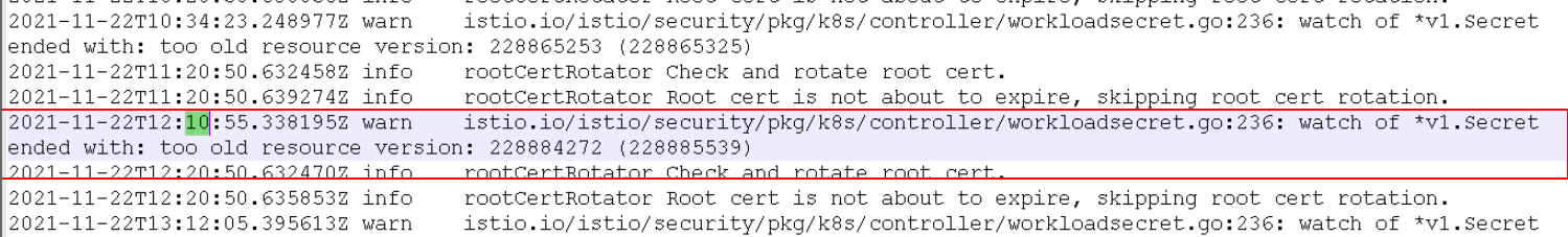

  2. If the client uses a certificate encryption mechanism such as istio, analyze certificate-related logs and check whether information similar to the following is displayed: If yes, the problem is caused by certificate expiration.
The expiration duration of the istio-citadel certificate is 45 days on the client. When the certificate has expired, the client initiates a database disconnection request.
