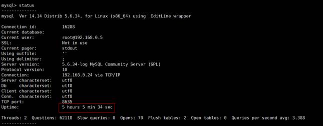

- Use the MySQL command-line client to connect to the target database. Run status to check whether the DB instance has been rebooted frequently.
Uptime indicates the running time of the DB instance. The command output shows that the database has not been restarted frequently. The client disconnection is not caused by a database restart.

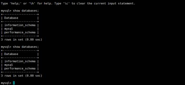

- After about 10 minutes, run the show databases command to check whether the connection is normal.
If information similar to the preceding figure is returned, the connection is normal.
