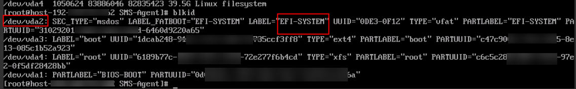

RHCOS automatically unmounts the /boot/efi directory after startup, but the files in the mount point must be accessible for migration. You can run the blkid command to find the device for the /boot/efi directory. Typically, the device is the partition labeled LABEL="EFI-SYSTEM".
Then, manually mount the partition. The command below is an example.mount /dev/vda2 /boot/efi
