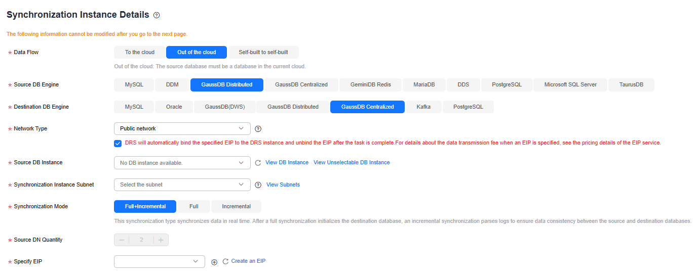

- Synchronization instance details Figure 1 Synchronization instance details
Table 6 Synchronization instance settings Parameter
Description
Data Flow
Select Out of the cloud.
Source DB Engine
Select GaussDB Distributed.
Destination DB Engine
Select GaussDB Centralized.
Network Type
Public network is used as an example. Available options: VPC, Public network, and VPN or Direct Connect
- VPC is suitable for data synchronization between cloud databases of the same account in the same region and VPC.
- Public network is suitable for data synchronization from on-premises or external cloud databases to the destination databases bound with an EIP.
- VPN or Direct Connect is suitable for data synchronization from on-premises databases to cloud databases, between databases of different accounts in the same region on the cloud, or between databases across regions on the cloud using a VPN, Direct Connect, Cloud Connect, VPCEP, or a VPC peering connection.
Source DB Instance
The distributed GaussDB instance you created.
Synchronization Instance Subnet
Select the subnet where the synchronization instance is located. You can also click View Subnets to go to the network console to view the subnet where the instance resides.
By default, the DRS instance and the destination DB instance are in the same subnet. You need to select the subnet where the DRS instance resides, and there are available IP addresses for the subnet. To ensure that the synchronization instance is successfully created, only subnets with DHCP enabled are displayed.
Synchronization Mode
Available options: Full+Incremental, Full, and Incremental. Full+Incremental is used as an example.
- Full+Incremental
This synchronization mode allows you to synchronize data in real time. After a full synchronization initializes the destination database, an incremental synchronization parses logs to ensure data consistency between the source and destination databases.
NOTE:If you select Full+Incremental, data generated during the full synchronization will be continuously synchronized to the destination database, and the source remains accessible.
- Full
In this mode, data is synchronized from the source to the destination at a time.
- Incremental
Through log parsing, incremental data generated on the source database is synchronized to the destination database.
Source DN Quantity
The value must be the same as the number of DNs in the distributed source database.
Specify EIP
This parameter is available when you select Public network for Network Type. Select an EIP to be bound to the DRS instance. DRS will automatically bind the specified EIP to the DRS instance and unbind the EIP after the task is complete. The number of specified EIPs must be the consistent with that of DB instances.

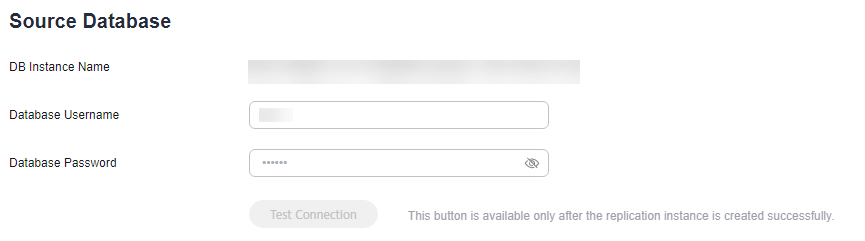

Figure 3 Source database information
Table 9 Source database settings Parameter
Description
DB Instance Name
The distributed GaussDB DB instance selected during synchronization task creation. This parameter cannot be changed.
Database Username
The username for accessing the source database.
Database Password
The password for the database username.
The username and password of the source database are encrypted and stored in the database and the synchronization instance during the synchronization. After the task is deleted, the username and password are permanently deleted.

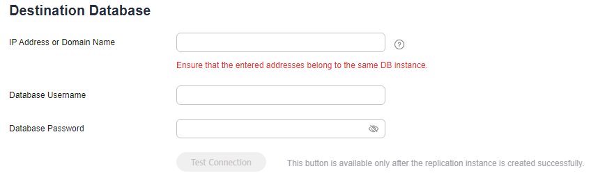

Figure 4 Destination database information
Table 10 Destination database settings Parameter
Description
IP Address or Domain Name
IP address or domain name of the destination database in the IP address/Domain name:Port format. The port of the destination database. Range: 1 - 65535
You can enter up to 10 groups of IP addresses or domain names of the destination database. Separate multiple values with commas (,). For example: 192.168.0.1:8080,192.168.0.2:8080.
Database Username
The username for accessing the destination database.
Database Password
The username and password of the destination database are encrypted and stored in the database and the synchronization instance during the synchronization. After the task is deleted, the username and password are permanently deleted.
