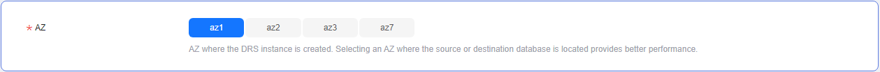

AZ
Select the AZ where you want to create the DRS task. Selecting the one housing the source or destination database can provide better performance.

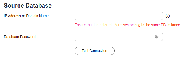

- Source database information Figure 2 Source database information
Table 8 Source database information Parameter
Description
IP Address or Domain Name
The IP address or domain name of the source database.
Port
The port of the source database. Range: 1 – 65535
Database Password
Password used to log in to the source database.
The IP address or domain name, and password of the source database are encrypted and stored in DRS, and will be cleared after the task is deleted.

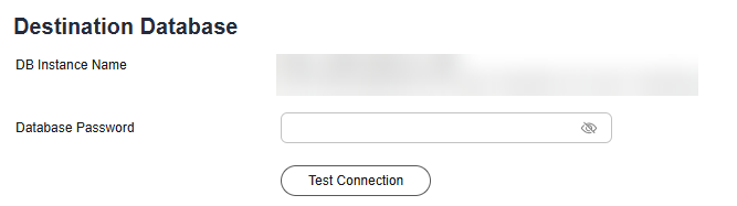

- Destination database configuration Figure 3 Destination database information
Table 9 Destination database settings Parameter
Description
DB Instance Name
The DB instance you selected when creating the synchronization task. This parameter cannot be changed.
Database Password
The password for the database username.
The password of the destination database is encrypted and stored in the database and the synchronization instance during the synchronization. After the task is deleted, the password are permanently deleted.

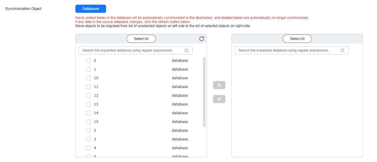

- On the Set Synchronization Task page, configure the objects to be synchronized, and then click Next. Figure 4 Synchronization objects
Table 10 Synchronization Object Parameter
Description
The left pane displays the source database objects, and the right pane displays the selected objects. DRS supports database-level synchronization. You can select the databases to be synchronized based on service requirements.
If there are changes made to the source databases or objects, click
in the upper right corner to update the objects to be synchronized.NOTE:- If an object name contains spaces, the spaces before and after the object name are not displayed. If there are two or more consecutive spaces in the middle of the object name, only one space is displayed.
- The name of the selected synchronization object cannot contain spaces.
- To quickly select the desired database objects, you can use the search function.

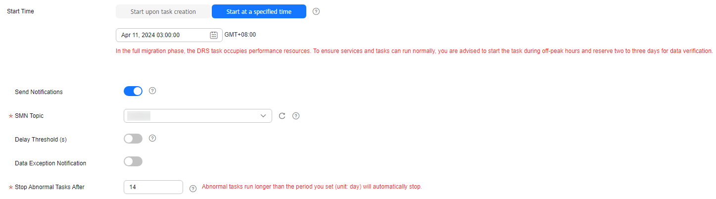

- On the displayed page, specify Start Time, Send Notifications, SMN Topic, Delay Threshold (s), and Stop Abnormal Tasks After, confirm that the configured information is correct, and click Submit to submit the task. Figure 5 Task startup settings
Table 11 Task startup settings Parameter
Description
Start Time
Set Start Time to Start upon task creation or Start at a specified time based on site requirements. The Start at a specified time option is recommended.
NOTE:The synchronization task may affect the performance of the source and destination databases. You are advised to start the task in off-peak hours and reserve two to three days for data verification.
Send Notifications
This parameter is optional. After enabled, select a SMN topic. If the task billing is about to start, the status, latency metric, or data of the synchronization task is abnormal, DRS will send you a notification.
SMN Topic
This parameter is available only after you enable Send Notifications and create a topic on the SMN console and add a subscriber.
For details, see Simple Message Notification User Guide.
Delay Threshold (s)
During an incremental synchronization, a synchronization delay indicates a time difference (in seconds) of synchronization between the source and destination database.
If the synchronization delay exceeds the threshold you specify, DRS will send alarms to the specified recipients. The value ranges from 0 to 3,600. To avoid repeated alarms caused by the fluctuation of delay, an alarm is sent only after the delay has exceeded the threshold for six minutes.
NOTE:- In the early stages of an incremental synchronization, the synchronization delay is long because a large quantity of data is awaiting synchronization. In this case, no notifications will be sent.
- Before setting the delay threshold, enable Send Notifications.
- If the delay threshold is set to 0, no notifications will be sent to the recipient.
Data Exception Notification
This parameter is optional. After enabled, DRS will send a notification if the task data is abnormal.
Number of days after which an abnormal task is automatically stopped. The value must range from 14 to 100. The default value is 14.
NOTE:Tasks in the abnormal state are still charged. If tasks remain in the abnormal state for a long time, they cannot be resumed. Abnormal tasks run longer than the period you set (unit: day) will automatically stop to avoid unnecessary fees.
