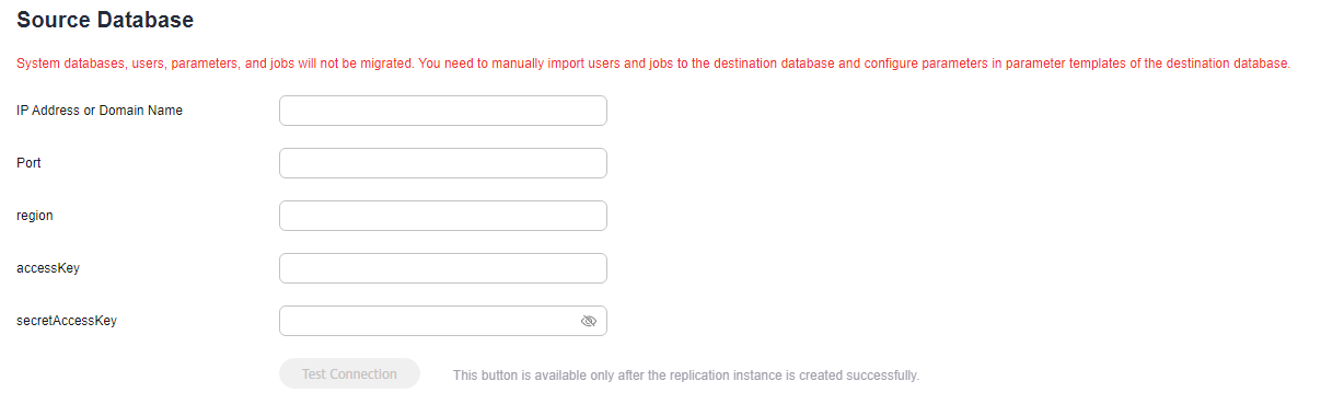

Table 9 Source database settings Parameter
Description
IP Address or Domain Name
The domain name of the source database. The value is in the format of dynamodb.<region>.amazonaws.com. For example, dynamodb.ap-northeast-.amazonaws.com.
Port
The port number of the source database. The default value is 80.
region
The region where the source database resides, for example, ap-northeast-3.
accessKey
IAM key for accessing the source DynamoDB database.
secretAccessKey

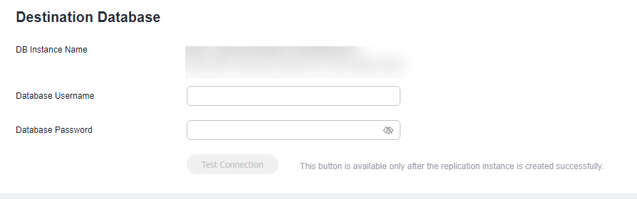

Figure 3 Destination database information
Table 10 Destination database settings Parameter
Description
DB Instance Name
The GeminiDB Cassandra instance selected when you create the synchronization task. This parameter cannot be changed.
Database Username
The username for accessing the destination database.
Database Password
The password for the database username.
The usernames and passwords of the source and destination databases are encrypted and stored in DRS and will be cleared after the task is deleted.

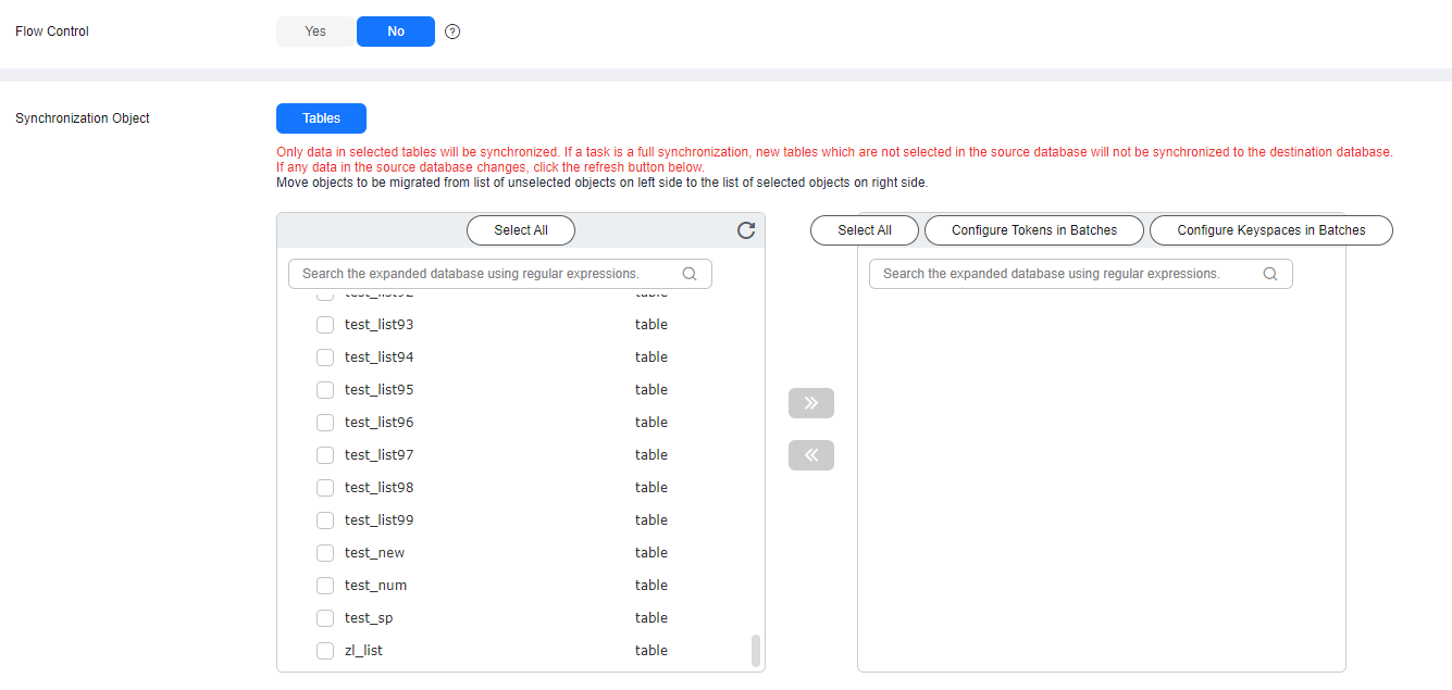

- On the Set Synchronization Task page, select the synchronization object type and synchronization objects, and click Next. Figure 4 Set synchronization task
Table 11 Synchronization mode and object Parameter
Description
Flow Control
You can choose whether to control the flow. Flow Control takes effect in the full phase only.
- Yes
You can customize the maximum synchronization speed. During the full synchronization, the synchronization speed of each task (or each subtask in multi-task mode) does not exceed the value of this parameter.
In addition, you can set the time range based on your service requirements. The traffic rate setting usually includes setting of a rate limiting time period and a traffic rate value. Flow can be controlled all day or during specific time ranges. The default value is Always. A maximum of 10 time ranges can be set, and they cannot overlap.
The flow rate must be set based on the service scenario and cannot exceed 9,999 MB/s.
Figure 5 Flow control
- No The synchronization speed is not limited and the outbound bandwidth of the source database is maximally used, which will increase the read burden on the source database. For example, if the outbound bandwidth of the source database is 100 MB/s and 80% bandwidth is used, the I/O consumption on the source database is 80 MB/s.NOTE:
- The flow control mode takes effect only in the full synchronization phase.
- You can also change the flow control mode after creating a task. For details, see Modifying the Flow Control Mode.
Synchronization Object
The left pane displays the source database objects, and the right pane displays the selected objects. DRS supports table-level synchronization. You can select data for synchronization based on your service requirements.
- On the right pane, you can set tokens for selected objects in batches.
- If the synchronization objects in source and destination databases have different names, you can map the source object name to the destination one. For details, see Changing Object Names (Mapping Object Names).
A mapped table name can contain 1 to 48 characters. Only letters, digits, and underscores (_) are allowed.
- You can select all objects to be synchronized and then set tokens and keyspaces in batches.
NOTE:- To quickly select the desired database objects, you can use the search function.
- If there are changes made to the source databases or objects, click
in the upper right corner to update the objects to be synchronized.
- If an object name contains spaces, the spaces before and after the object name are not displayed. If there are two or more consecutive spaces in the middle of the object name, only one space is displayed.
- The name of the selected synchronization object cannot contain spaces.
