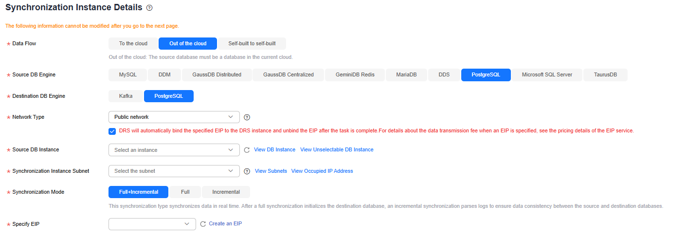

- Synchronization instance details Figure 1 Synchronization instance details
Table 6 Synchronization instance settings Parameter
Description
Data Flow
Select Out of the cloud.
Source DB Engine
Select PostgreSQL.
Destination DB Engine
Select PostgreSQL.
Network Type
Available options: VPC, Public network, and VPN or Direct Connect. VPC is used as an example.
- VPC is suitable for data synchronization between cloud databases of the same account in the same region and VPC.
- Public network is suitable for data synchronization from on-premises or external cloud databases to the destination databases bound with an EIP.
- VPN or Direct Connect is suitable for data synchronization from on-premises databases to cloud databases, between databases of different accounts in the same region on the cloud, or between databases across regions on the cloud using a VPN, Direct Connect, Cloud Connect, VPCEP, or a VPC peering connection.
Source DB Instance
The RDS for PostgreSQL DB instance.
Synchronization Instance Subnet
Select the subnet where the synchronization instance is located. You can also click View Subnets to go to the network console to view the subnet where the instance resides.
By default, the DRS instance and the destination DB instance are in the same subnet. You need to select the subnet where the DRS instance resides, and there are available IP addresses for the subnet. To ensure that the synchronization instance is successfully created, only subnets with DHCP enabled are displayed.
Synchronization Mode
- Full+Incremental
This synchronization mode allows you to synchronize data in real time. After a full synchronization initializes the destination database, an incremental synchronization parses logs to ensure data consistency between the source and destination databases.
- Full
All objects and data in non-system databases are synchronized to the destination database at a time. This mode is applicable to scenarios where service interruption is acceptable.
- Incremental
Through log parsing, incremental data generated on the source database is synchronized to the destination database.
Specify EIP
This parameter is available when you select Public network for Network Type. Select an EIP to be bound to the DRS instance. DRS will automatically bind the specified EIP to the DRS instance and unbind the EIP after the task is complete. The number of specified EIPs must be the consistent with that of DB instances.

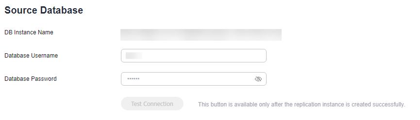

- Source database configuration Figure 3 Source database information
Table 9 Source database settings Parameter
Description
DB Instance Name
The RDS for PostgreSQL instance you selected when creating the task. The parameter cannot be changed.
Database Username
The username for accessing the source database.
Database Password
The password for the database username.

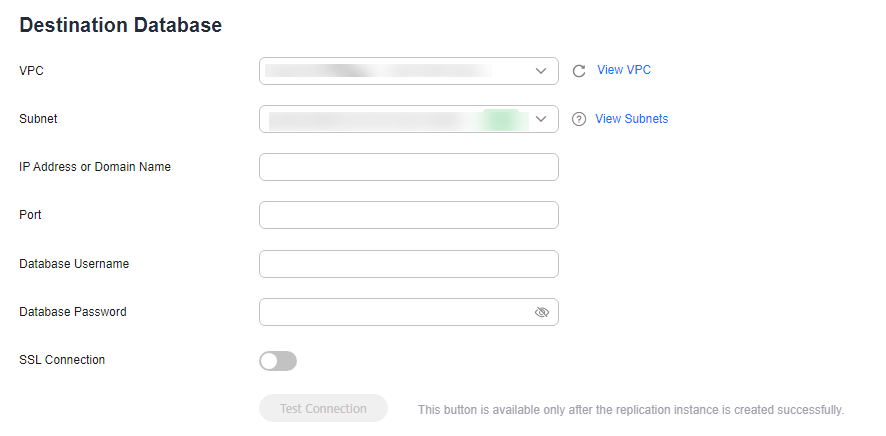

- Destination database configuration Figure 4 Destination database information
Table 10 Destination database settings Parameter
Description
VPC
A dedicated virtual network in which the destination database is located. It isolates networks for different services. You can select an existing VPC or create a VPC.
Subnet
A subnet provides dedicated network resources that are isolated from other networks, improving network security. The subnet must be in the AZ where the destination database resides. You need to enable DHCP for creating the destination database subnet.
IP Address or Domain Name
The IP address or domain name of the destination database.
Port
The port of the destination database. Range: 1 - 65535
Database Username
The username for accessing the destination database.
Database Password
SSL Connection
SSL encrypts the connections between the source and destination databases.
The username and password of the source and destination databases are encrypted and stored in the databases and the synchronization instance during the synchronization. After the task is deleted, the username and password are permanently deleted.

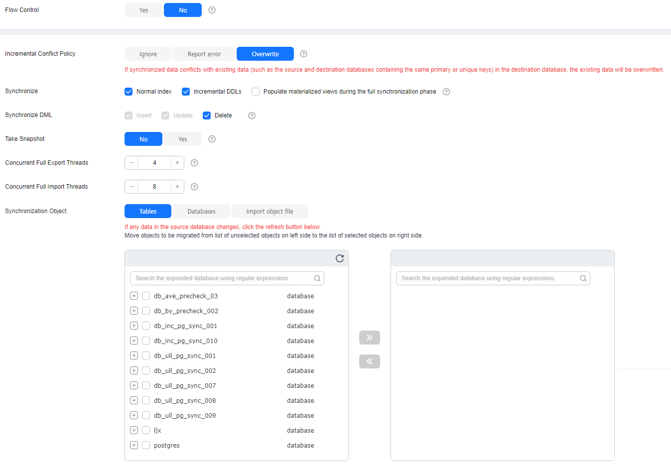

- On the Set Synchronization Task page, select the synchronization policy and synchronization object, and click Next. Figure 5 Set synchronization task
Table 11 Synchronization Object Parameter
Description
Flow Control
You can choose whether to control the flow. Flow Control takes effect in the full phase only.
- Yes
You can customize the maximum synchronization speed. During the full synchronization, the synchronization speed of each task (or each subtask in multi-task mode) does not exceed the value of this parameter.
In addition, you can set the time range based on your service requirements. The traffic rate setting usually includes setting of a rate limiting time period and a traffic rate value. Flow can be controlled all day or during specific time ranges. The default value is Always. A maximum of 10 time ranges can be set, and they cannot overlap.
The flow rate must be set based on the service scenario and cannot exceed 9,999 MB/s.
Figure 6 Flow control
- No The synchronization speed is not limited and the outbound bandwidth of the source database is maximally used, which will increase the read burden on the source database. For example, if the outbound bandwidth of the source database is 100 MB/s and 80% bandwidth is used, the I/O consumption on the source database is 80 MB/s.NOTE:
- The flow control mode takes effect only in the full synchronization phase.
- You can also change the flow control mode after creating a task. For details, see Modifying the Flow Control Mode.
Incremental Conflict Policy
The conflict policy refers to the conflict handling policy during incremental synchronization. By default, conflicts in the full synchronization phase are ignored. Select any of the following conflict policies:
- Ignore
The system will skip the conflicting data and continue the subsequent synchronization process. If you select Ignore, data in the source database may be inconsistent with that in the destination database.
- Report error
- Overwrite
If the synchronized data conflicts with the existing data in the destination database, selecting Ignore cannot ensure data consistency. To ensure data consistency, select Overwrite.
Synchronize
Available options: Normal index, Incremental DDLs, and Populate materialized views during the full synchronization phase
Populate materialized views during the full synchronization phase: This option takes effect only for materialized views that was populated in the source database. This operation affects the full synchronization performance. You perform this operation after the full synchronization is complete.
Synchronize DML
Select the DML operations to be synchronized. By default, all DML operations are selected.
If you do not select Delete, DELETE statements in the incremental data of the source database will not be synchronized, which may cause a data inconsistency. As a result, there may be a data conflict or the task may fail.
Source Database Replication Slot Name
You can choose whether to specify the replication slot of the source database. This parameter is available for incremental tasks. After replication slot is enabled, enter the replication slot name. The name can contain a maximum of 63 characters and cannot start with a digit. Only lowercase letters, digits, and underscores (_) are allowed.
Take Snapshot
If you perform a full+incremental migration, you can take a snapshot for your databases.
Exporting data in snapshot mode in the full export phase can effectively improve the data synchronization efficiency in the full+incremental export scenario. However, the snapshot mechanism of PostgreSQL prevents historical data in the database from being reclaimed during the export, which may cause space expansion. You are advised to use this method when the full or incremental data volume is large and the source database disk space is sufficient.
The left pane displays the source database objects, and the right pane displays the selected objects. You can select Tables, Import object file, or Databases for Synchronization Object as required.
- Database-level synchronization: In full synchronization, the selected databases and the inventory data of the database objects are synchronized. In incremental synchronization, the DML and some DDL statements of all tables except unlogged tables and temporary tables are synchronized.
- Table-level synchronization: In full synchronization, the inventory data of the selected tables, sequences, views, or materialized views is synchronized. In incremental synchronization, the DML and some DDL statements of the selected tables are synchronized.
- If the synchronization objects in source and destination databases have different names, you can map the source object name to the destination one. For details, see Changing Object Names (Mapping Object Names).
When a schema name or table name is mapped, to prevent conflicts between indexes and constraint names, the original index name in the table is changed to the following format after synchronization: i_+hash value+original index name (which may be truncated)+_key The hash value is calculated based on the original schema name_original table name_original index name. Similarly, after the synchronization, the original constraint name on the table is changed to c_ + hash value + original constraint name (which may be truncated) + _key.
- For details about how to import an object file, see Importing Synchronization Objects.
NOTE:- To quickly select the desired database objects, you can use the search function.
- If there are changes made to the source databases or objects, click
in the upper right corner to update the objects to be synchronized.
- If an object name contains spaces, the spaces before and after the object name are not displayed. If there are two or more consecutive spaces in the middle of the object name, only one space is displayed.
- The name of the selected synchronization object cannot contain spaces.
