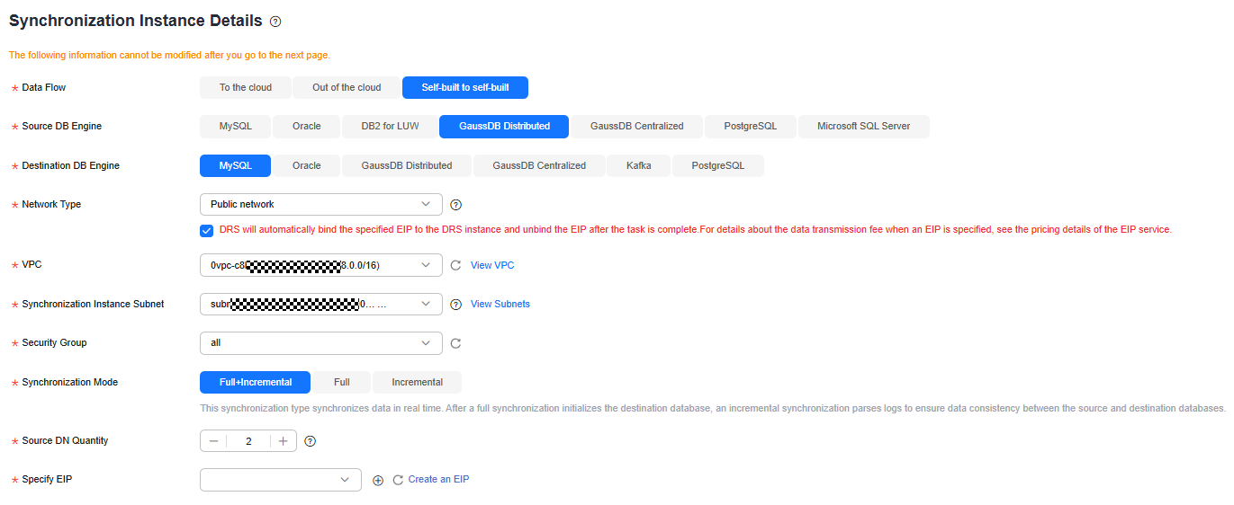

- Synchronization instance details Figure 1 Synchronization instance details
Table 6 Synchronization instance settings Parameter
Description
Data Flow
Choose Self-built to self-built.
Source DB Engine
Select GaussDB Distributed.
Destination DB Engine
Select MySQL.
Network Type
Public network is used as an example. Available options: Public network and VPN or Direct Connect
VPC
Select an available VPC.
Synchronization Instance Subnet
Select the subnet where the synchronization instance is located. You can also click View Subnets to go to the network console to view the subnet where the instance resides.
By default, the DRS instance and the destination DB instance are in the same subnet. You need to select the subnet where the DRS instance resides, and there are available IP addresses for the subnet. To ensure that the synchronization instance is successfully created, only subnets with DHCP enabled are displayed.
If you select VPN or Direct Connect for Network Type, you can enter a specified IP address. When creating multiple tasks at the same time, do not specify the same group of unused IP addresses. Otherwise, the tasks fail to be created.
Security Group
Select a security group. You can use security group rules to allow or deny access to the instance.
Synchronization Mode
Available options: Full+Incremental, Incremental, and Full
- Full+Incremental
This synchronization mode allows you to synchronize data in real time. After a full synchronization initializes the destination database, an incremental synchronization parses logs to ensure data consistency between the source and destination databases.
NOTE:If you select Full+Incremental, data generated during the full synchronization will be continuously synchronized to the destination database, and the source remains accessible.
- Full
All objects and data in non-system databases are synchronized to the destination database at a time. This mode is applicable to scenarios where service interruption is acceptable.
- Incremental
Through log parsing, incremental data generated on the source database is synchronized to the destination database.
Source DN Quantity
The value must be the same as the number of DNs in the distributed source database.
Specify EIP
This parameter is available when you select Public network for Network Type. Select an EIP to be bound to the DRS instance. DRS will automatically bind the specified EIP to the DRS instance and unbind the EIP after the task is complete. The number of specified EIPs must be the consistent with that of DB instances.

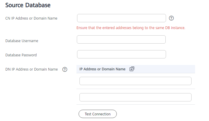

Figure 3 Source database information
Table 9 Source database settings Parameter
Description
CN IP Address or Domain Name
Enter the IP addresses of GaussDB. Ensure that the entered IP addresses or domain names belong to the same instance.
Database Username
The username for accessing the source database.
Database Password
The password for the database username.
DN IP Address or Domain Name
You can log in to the CN node and run the SQL statement to query the DN IP address.
The resource types of different database instances are different. Therefore, you are advised to contact O&M personnel.
The username and password of the source database are encrypted and stored in the database and the synchronization instance during the synchronization. After the task is deleted, the username and password are permanently deleted.

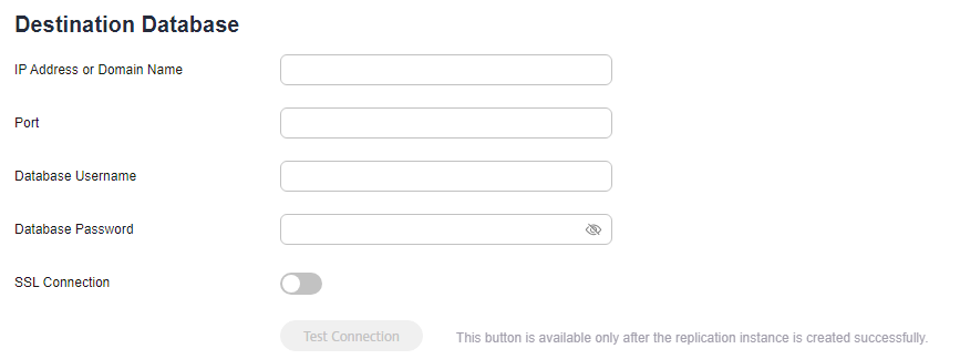

Figure 4 Destination database information
Table 10 Destination database settings Parameter
Description
The IP address or domain name of the destination database.
Port
The port of the destination database. Range: 1 - 65535
Database Username
The username for accessing the destination database.
Database Password
SSL Connection
SSL encrypts the connections between the source and destination databases. If SSL is enabled, upload the SSL CA root certificate.
NOTE:- The maximum size of a single certificate file that can be uploaded is 500 KB.
- If SSL is disabled, your data may be at risk.
The username and password of the destination database are encrypted and stored in the database and the synchronization instance during the synchronization. After the task is deleted, the username and password are permanently deleted.
