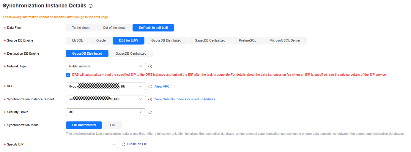

- Synchronization instance details Figure 1 Synchronization instance details
Table 4 Synchronization instance settings Parameter
Description
Data Flow
Choose Self-built to self-built.
Source DB Engine
Select DB2 for LUW.
Destination DB Engine
Select GaussDB Distributed.
Network Type
Public network is used as an example. Available options: Public network and VPN or Direct Connect
VPC
Select an available VPC.
Synchronization Instance Subnet
Select the subnet where the synchronization instance is located. You can also click View Subnets to go to the network console to view the subnet where the instance resides.
By default, the DRS instance and the destination DB instance are in the same subnet. You need to select the subnet where the DRS instance resides, and there are available IP addresses for the subnet. To ensure that the synchronization instance is successfully created, only subnets with DHCP enabled are displayed.
Security Group
Select a security group. You can use security group rules to allow or deny access to the instance.
Synchronization Mode
- Full+Incremental
This synchronization mode allows you to synchronize data in real time. After a full synchronization initializes the destination database, an incremental synchronization parses logs to ensure data consistency between the source and destination databases.
- Full
All objects and data in non-system databases are synchronized to the destination database at a time. This mode is applicable to scenarios where service interruption is acceptable.
Specify EIP
This parameter is available when you select Public network for Network Type. Select an EIP to be bound to the DRS instance. DRS will automatically bind the specified EIP to the DRS instance and unbind the EIP after the task is complete. The number of specified EIPs must be the consistent with that of DB instances.

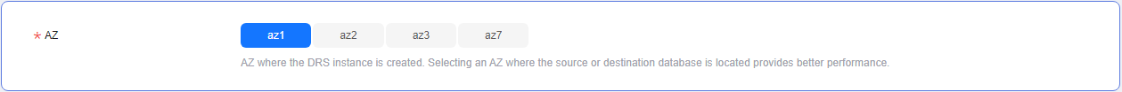

- Full+Incremental
- AZ Figure 2 AZ
Table 5 Task AZ Parameter
Description
AZ
Select the AZ where you want to create the DRS task. Selecting the one housing the source or destination database can provide better performance.

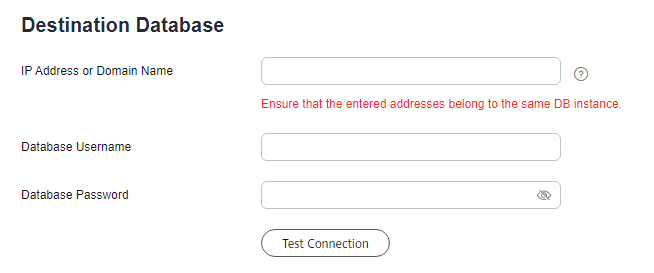

Figure 4 Destination database information
Table 8 Destination database settings Parameter
Description
IP Address or Domain Name
IP address or domain name of the destination database in the IP address/Domain name:Port format. The port of the destination database. Range: 1 - 65535
You can enter up to 10 groups of IP addresses or domain names of the destination database. Separate multiple values with commas (,). Example: 192.168.0.1:8000,192.168.0.2:8000
Database Username
The username for accessing the destination database.
Database Password
The password for the database username.
The username and password of the destination database are encrypted and stored in DRS, and will be cleared after the task is deleted.
