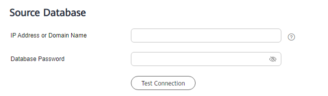

- Source database information Figure 3 Source database information
Table 8 Source database settings Parameter
Description
IP Address or Domain Name
IP address or domain name of the source database in the IP address/Domain name:Port format.
Enter the IP addresses and ports of all shards in the source Redis Cluster instance. You are advised to enter the IP addresses of all shard slave nodes. Up to 32 IP addresses or domain names can be entered. Use commas (,) to separate multiple IP addresses or domain names. For example: 192.168.0.1:8080,192.168.0.2:8080.
Database Password
Password used to log in to the source database.
SSL Connection
If SSL connection is required, enable SSL on the source database, ensure that related parameters have been correctly configured, and upload an SSL certificate.
NOTE:- The maximum size of a single certificate file that can be uploaded is 500 KB.
- If SSL is disabled, your data may be at risk.
The IP address or domain name, and password of the source database are encrypted and stored in DRS, and will be cleared after the task is deleted.

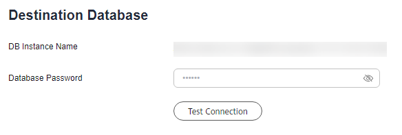

- Destination database configuration Figure 4 Destination database information
Table 9 Destination database settings Parameter
Description
DB Instance Name
The DB instance you selected when creating the migration task. This parameter cannot be changed.
Database Password
The password for the database username.
SSL Connection
If SSL connection is required, enable SSL on the destination database, ensure that related parameters have been correctly configured, and upload an SSL certificate.
The password of the destination database is encrypted and stored in the database and the replication instance during the migration. After the task is deleted, the password is permanently deleted.
