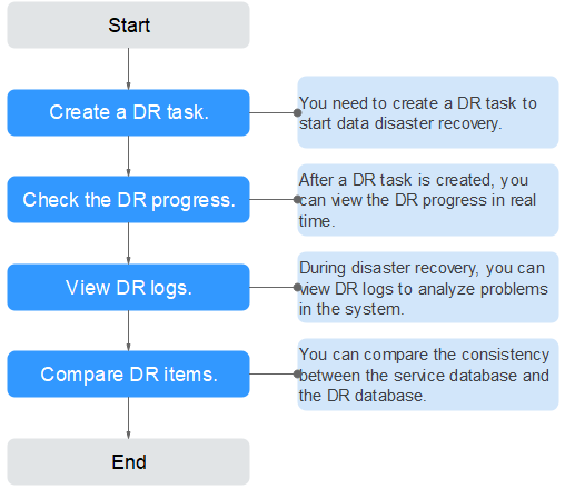

Process
The following flowchart shows the basic processes for disaster recovery.
- Step 1: Create a DR task. Select the service and DR databases as required and create a DR task.
- Step 2: Query the DR progress. During the disaster recovery, you can view the DR progress.
- Step 3: View DR logs. Disaster recovery logs contain alarms, errors, and prompt information. You can analyze system problems based on such information.
- Step 4: Compare DR items. The DR system supports object-level, data-level comparison to ensure data consistency.
