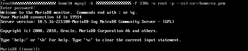

  8. Enter the password of the database account if the following information is displayed:
    Enter password:
    Figure 1 Connection example
    If the connection fails, ensure that preparations have been correctly made in Prerequisites and try again.
