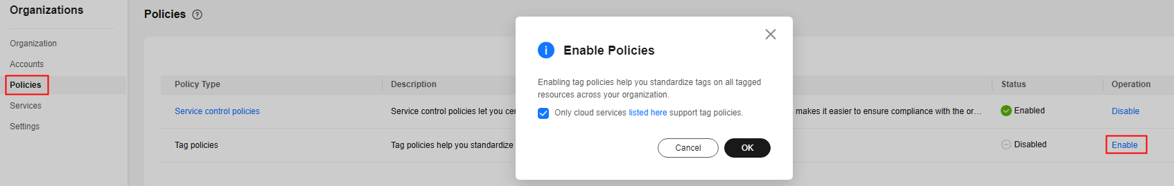

- Log in to the management console as the organization administrator or using the management account, and navigate to the Organizations console.
- On the Policies page, locate Tag policies, and click Enable in the Operation column.
- In the displayed dialog box, select the check box and click OK.

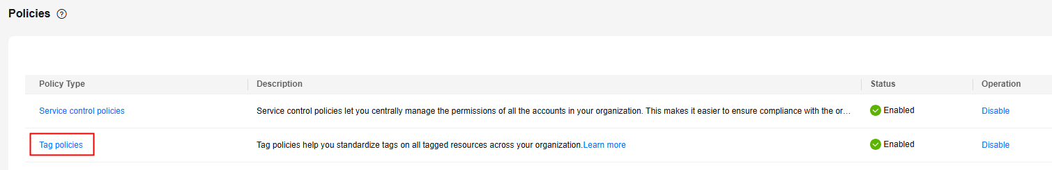

- Click Tag policies. The list of tag policies is displayed.

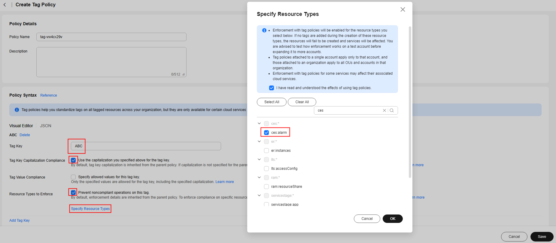

- Click Create Policy. The Create Tag Policy page is displayed.
- Set parameters for the tag policy based on the table below, and retain the default values for other parameters.
Parameter
Example
Setting
Tag Key
ABC
Enter the key (ABC in this example) for the tag you want to define in the tag policy.
The tag policy will apply only to tags with this tag key.
Tag Key Capitalization Compliance
Selected
Use the capitalization you specified for the tag key for compliance check.
If you select this option, tag keys in all uppercase characters like ABC are considered compliant, and those in all lowercase characters like abc or both uppercase and lowercase characters (such as Abc) are considered non-compliant. The tag policy will prevent you from adding any non-compliant tags to your resources.
Resource Types to Enforce
ces:alarm
Specify resource types to enforce the tag policy.
Select the Prevent noncompliant operations on this tag. option and click Specify Resource Types. In the displayed dialog box, read and confirm the effects of using tag policies. Then, select resource types and click OK.
- Click Save in the lower right corner.
