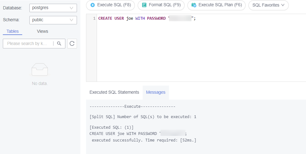

- Create a database user.
Only administrators that are created during the instance installation can access the initial database by default. You can also create other database users.
CREATE USER joe WITH PASSWORD "xxxxxxxxx";
If information similar to the following is displayed, the creation is successful.
Figure 1 Creating a database user
In this case, you have created a user named joe, and the user password is xxxxxxx.

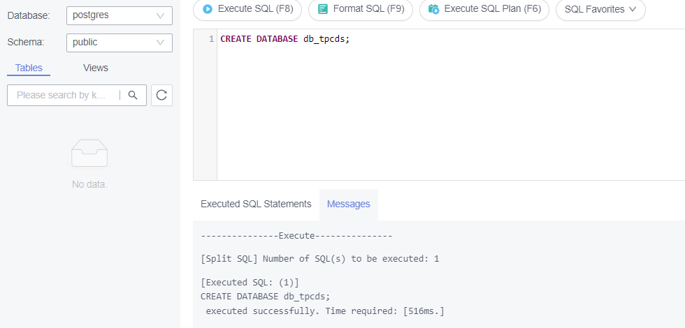

- Create a database.
CREATE DATABASE db_tpcds;
Figure 2 Creating a database
Switch to the newly created database in the upper left corner.
Figure 3 Switching to the new database

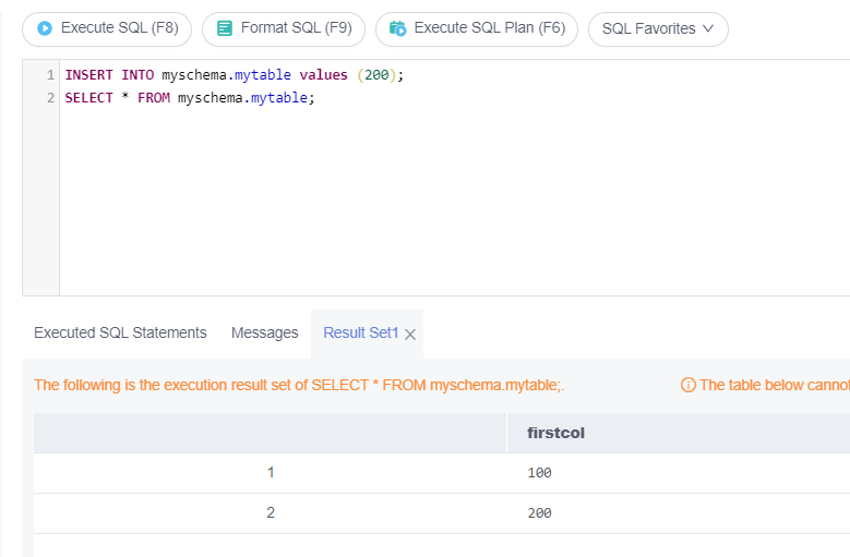

- Log in to the db_tpcds database as user joe.
- After login, insert data into the table and verify the data.
INSERT INTO myschema.mytable values (200);
SELECT * FROM myschema.mytable;
Figure 4 Inserting and verifying data
