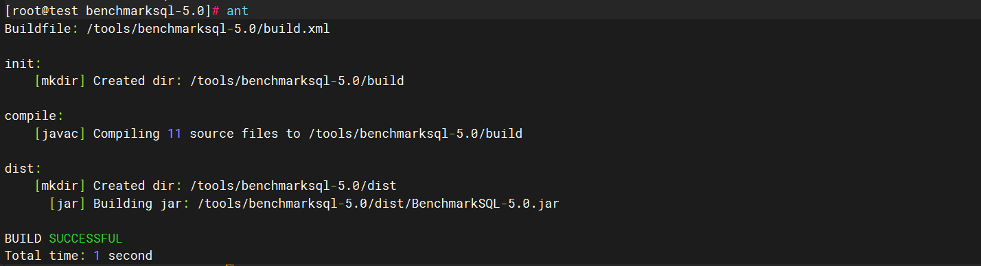

- Go to the directory created after decompressing the BenchmarkSQL installation package, and use Apache Ant to compile BenchmarkSQL.
cd /home/benchmarksql-5.0 ant
If the following information is displayed, the compilation is successful.
