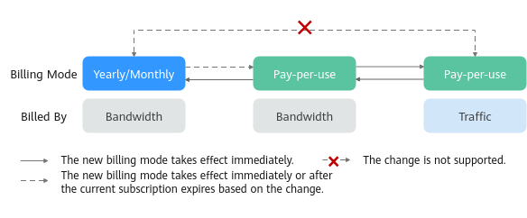

From yearly/monthly to pay-per-use
  • An EIP billed on a yearly/monthly basis can be directly changed to be billed on a pay-per-use basis (billed by bandwidth).
  • An EIP billed on a yearly/monthly basis cannot be directly changed to be billed on a pay-per-use basis (billed by traffic). To change this:
    1. Change the yearly/monthly EIP to be billed by bandwidth on a pay-per-use basis.
    2. Change the EIP billed by bandwidth on a pay-per-use basis to be billed by traffic on a pay-per-use basis.
The new billing mode takes effect only after the yearly/monthly subscription expires, if you want to change the EIP to be billed by bandwidth on a pay-per-use basis upon expiration.
The new billing mode takes effect immediately, if you want to change the EIP to be billed by bandwidth on a pay-per-use basis immediately.
From pay-per-use to yearly/monthly
  • An EIP that is billed by bandwidth on a pay-per-use basis can be directly changed to be billed on a yearly/monthly basis.
  • An EIP that is billed by traffic on a pay-per-use basis cannot be directly changed to be billed on a yearly/monthly basis. To change this:
    1. Change the EIP billed by traffic on a pay-per-use basis to be billed by bandwidth on a pay-per-use basis.
    2. Change the EIP billed by bandwidth on a pay-per-use basis to be billed on a yearly/monthly basis.
After the change is successful, the new billing mode takes effect immediately.
