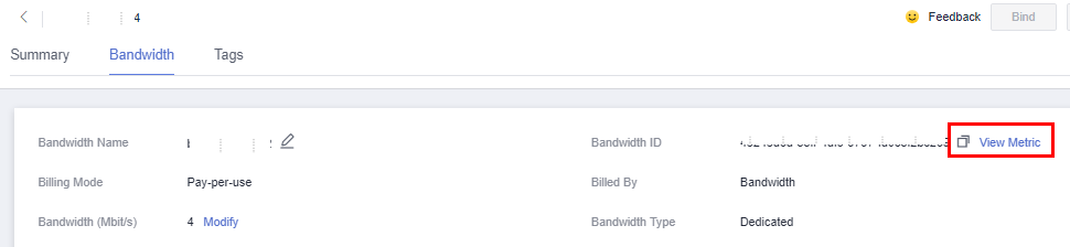

    • To view the bill of a fixed bandwidth, obtain the bandwidth ID.
      1. Click the target EIP. On the page providing details about the EIP, click the Bandwidth tab.
      2. Click the icon shown in the figure below to copy the bandwidth ID.
        Figure 2 Obtaining the bandwidth ID

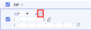

  2. Obtain the EIP or the bandwidth name.
    • To view the bill of an EIP, obtain the EIP name.
      Click the icon shown in the figure below to copy the EIP.
      Figure 3 Obtaining the EIP

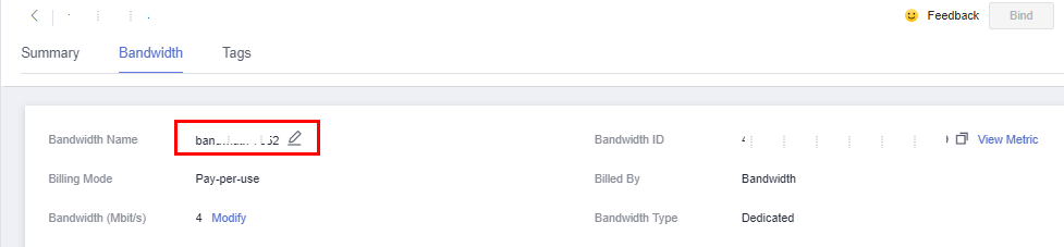

    • To view the bill of a fixed bandwidth, obtain the bandwidth name.
      2. Click the icon shown in the figure below to copy the bandwidth name.
        Figure 4 Obtaining the bandwidth name
