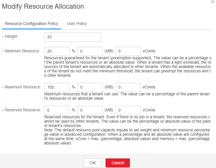

- Superior Scheduler
- On the Resource Configuration Policy tab of the Modify Resource Allocation window, set the resource configuration policy of the queue in the resource pool.
Figure 1 Resource configuration policy
- Weight: The task queue with a larger weight preempts resources first when resources are insufficient. Its initial value is the same as the minimum resource percentage.
- Minimum Resource: indicates the minimum resources that a tenant can obtain.
- Maximum Resource: indicates the maximum resources that a tenant can obtain.
- Reserved Resource: indicates the resources that are reserved for the tenant's queues and cannot be lent to other tenants' queues.
