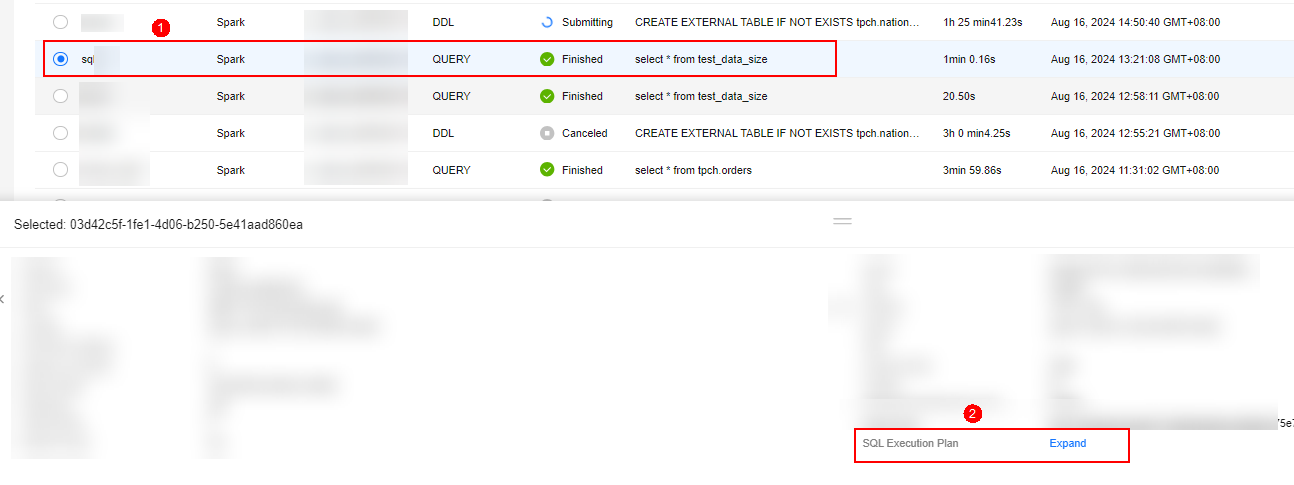

- At the bottom of the page, click the name of the job you selected to view its details.
In the details area, click Expand next to SQL Execution Plan. The system queries the SQL execution plan of the job from the DLI job bucket and displays the plan on the console.
If the SQL execution plan in the DLI job bucket is deleted, the plan may not be displayed because the source file is missing.
Figure 1 Viewing a SQL execution plan
