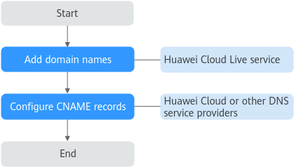

Domain Name Admission Process
Figure 1 shows the process of using your own domain name for livestreaming acceleration.
Figure 1 Admission process
  1. Add an ingest domain name and a streaming domain name (both licensed) to Media Live.
  2. Configure CNAME records at your domain names' DNS providers so that the CNAME records allocated to Live point to the domain names.

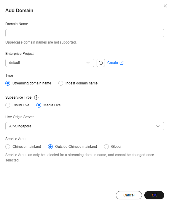

Procedure
  1. Log in to the Live console.
  2. In the navigation pane, choose Domains.
  3. Click Add Domain. On the displayed page, enter a streaming domain name or an ingest domain name.
    A PUSH channel requires an ingest domain name and a streaming domain name, while a PULL channel requires only a streaming domain name.
    Figure 2 Adding a domain name
    Table 1 Parameters
    Parameter
    Description
    Domain Name
    Enter a second-level ingest domain name or streaming domain name, for example, test-push.example.com.
    NOTE:
    • The domain name can contain a maximum of 64 characters, which cannot contain uppercase letters.
    • An ingest domain name must be different from a streaming domain name. Wildcard domains are not allowed.
    • By default, you can add up to 64 domain names in your account. To add more domain names, submit a service ticket.
    Enterprise Project
    Add domain names to enterprise projects for unified management.
    On the Create Enterprise Project page, create an enterprise project (whose name is default by default) and add the user group to the enterprise project. By doing so, users in this user group obtain the permissions on the domain names in the enterprise project.
    NOTE:
    Only an enterprise account can configure enterprise projects.
    Type
    If you enter an ingest domain name for Domain Name, then select Ingest Domain Name for Type. The domain name type cannot be changed once configured.
    Subservice Type
    Subservice type of the Live service.
    Options:
    • Cloud Live: This easy-to-use livestreaming service provides diverse live acceleration capabilities for entertainment, e-commerce, and education scenarios.
    • Media Live: This broadcast-grade livestreaming service supports features such as channel management and content encryption, making it an ideal option for media assets and broadcasting.
    Select Media Live.
    Live Origin Server
    Area where the Live origin server is located. For details, see How Do I Select a Live Origin Server and Acceleration Area? The Live origin server cannot be changed once configured. Select the nearest origin server.
    Currently, Live is supported in the following regions:
    • CN North-Beijing4 of Huawei Cloud (Chinese Mainland)
    • AP-Singapore, ME-Riyadh, CN-Hong Kong, and AF-Johannesburg of Huawei Cloud (Singapore)
      By default, ME-Riyadh, CN-Hong Kong, and AF-Johannesburg are unavailable. To select these regions, submit a service ticket to contact Huawei Cloud technical support.
    • Dublin of Huawei Cloud (Europe): EU-Dublin.
    Service Area
    Area where streaming domain names can be accelerated. For details, see How Do I Select a Live Origin Server and Acceleration Area? This parameter is valid only for streaming domain names, and cannot be changed once configured.
    If the video is not played in the selected acceleration area, the livestreaming quality may be compromised. Select an acceleration area that fits your needs.
    Options:
    • Europe
      Select this option when the audience is in Europe.
    • Global
      Select this option when the audience is not in Europe.
    NOTICE:
    If the Service Area you select involves cross-border data transfer, you shall be responsible for such transfer. For details, see section 2.3 "Processing Your Content Data" of Live Service Agreement.
    Stream Push Protocol
    The parameter is displayed only when an ingest domain name is added.
    Stream push protocol of Media Live.
    Options:
    • RTMP: RTMP_PUSH channels require RTMP ingest domain names.
    • SRT: SRT_PUSH channels require SRT ingest domain names.
  4. Click OK.
    A domain name whose Status is Configuring is displayed in the domain name list. About 3 to 5 minutes later, if the status becomes Normal, the domain name has been added.
