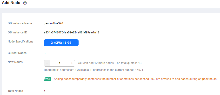

- In the Node Information area on the Basic Information page, click Add Node.
- Specify Add Nodes and click Next.

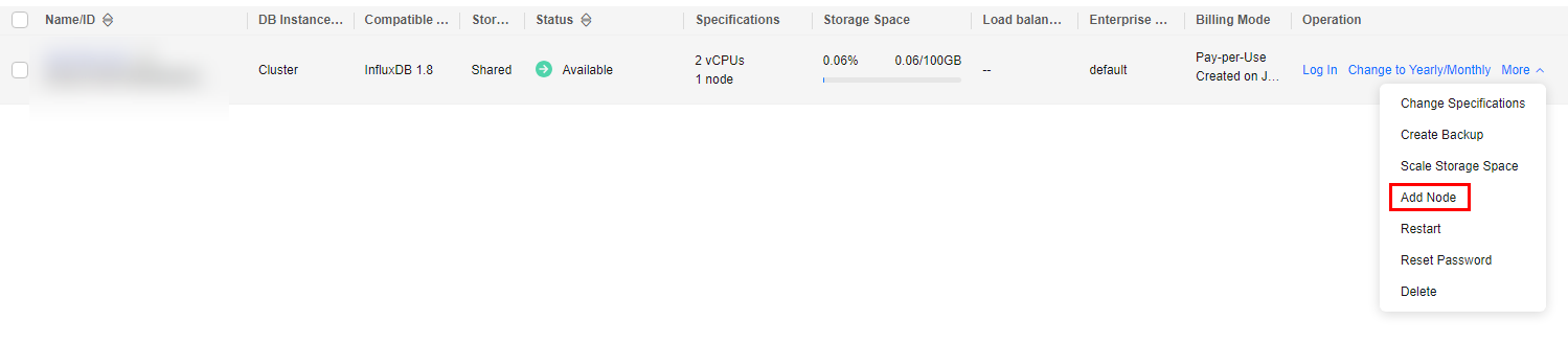

- On the Instances page, locate the instance you want to add nodes for and choose
in the Operation column.Figure 1 Adding a node
Figure 2 Adding a node
