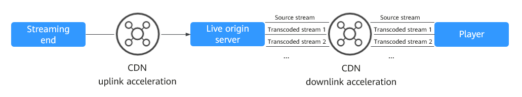

You can transcode livestreams into video streams with different resolutions and bitrates to meet a broad range of requirements.
Figure 1 Transcoding architecture
Function Overview
The transcoding function allows you to:
  • Transcode source audio and video into one or more formats for playback on a wide range of devices.
  • Adapt the output bitrate to different network bandwidths.
  • Reduce the costs of distributing livestreams. H.265 codec and low-bitrate HD can reduce the bitrate by about 20% at the same resolution.
  • Customize a transcoding template with settings such as ID, resolution, bitrate, and frame rate.

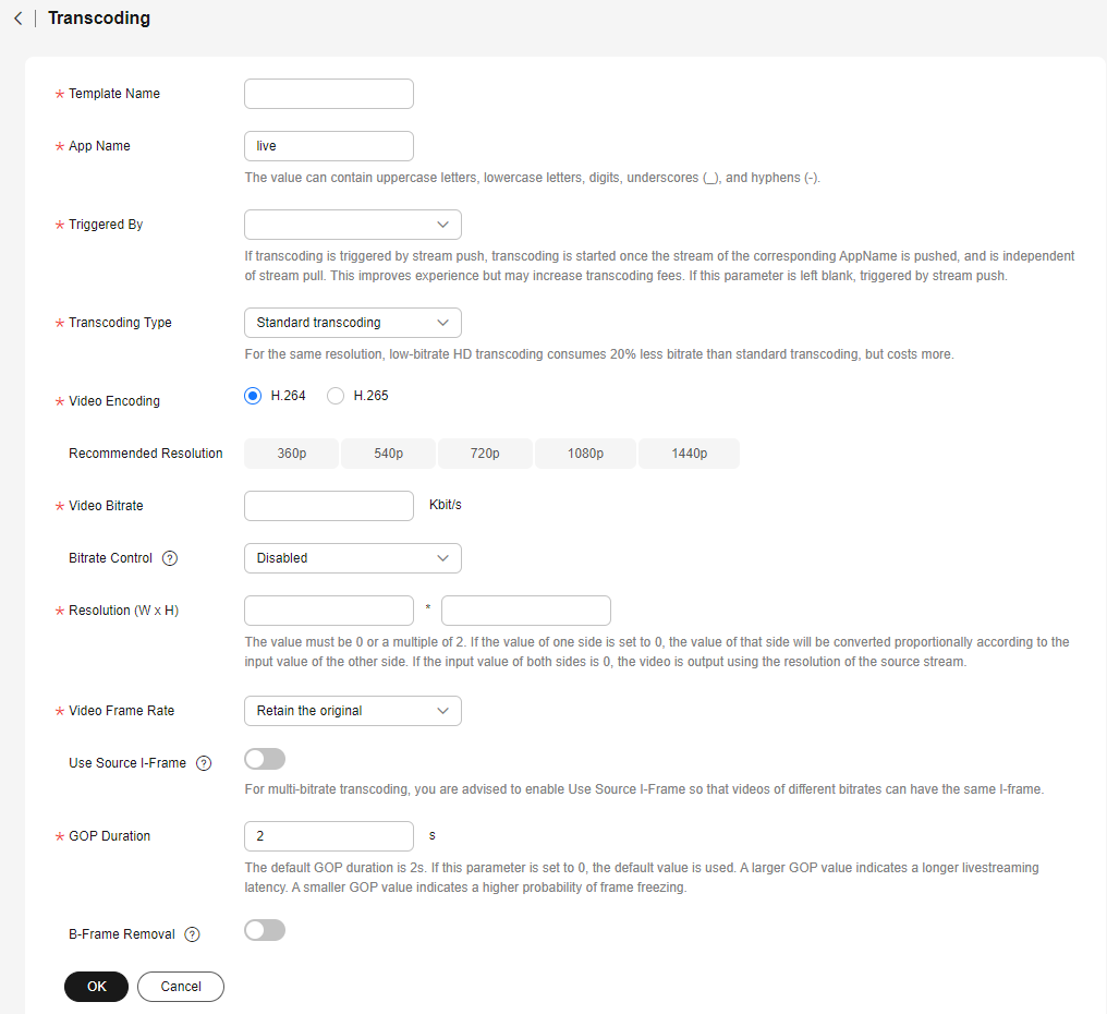

  5. Click Create Transcoding Template. The Create Transcoding Template page is displayed, as shown in Figure 2.
    Configure transcoding parameters based on Table 1.
    Figure 2 Creating a transcoding template
    Table 1 Transcoding template parameters
    Parameter
    Description
    Template Name
    Name of the transcoding template. Chinese characters are not supported.
    App Name
    Application name. The default value is live.
    You can customize the application name. Only letters, digits, underscores (_), and hyphens (-) are allowed.
    Triggered By
    Cloud Live transcoding can be triggered by stream push or stream pull. An application can have up to 20 transcoding templates.
    • Transcoding triggered by stream push: When a stream is pushed, a transcoding task is initiated, and the corresponding transcoding fee is generated. If multiple transcoding templates are configured for an application, each template generates its own transcoded stream and incurs the corresponding transcoding fee, regardless of whether the streams are pulled.
    • Transcoding triggered by stream pull: When a viewer plays a livestream, only the transcoding template corresponding to the pulled stream generates a transcoded stream and incurs the corresponding fee.
    Note: Transcoding templates are distinguished by name. Templates with different names are treated as different templates, even if they use identical parameter settings.
    The default value is Stream pull. If no value is specified, transcoding is triggered by stream push.
    CAUTION:
    • The triggering mode must be consistent across all transcoding templates in an application. Changing the Triggered By value for any template will update all templates under the application to that mode.
    • If multiple transcoding templates are configured, the transcoding price is aggregated based on the output specifications of each transcoding template.
    Transcoding Type
    Live transcoding type.
    Options:
    • Standard transcoding
    • Low-bitrate HD
    For the same resolution, low-bitrate HD transcoding consumes 20% less bitrate than standard transcoding but costs more.
    Low-bitrate HD means achieving the same image quality at a lower output bitrate. If you enable this function, you will be billed based on the rates of low-bitrate HD. For details, see Live Pricing Details.
    Video Encoding
    H.264 and H.265 are supported.
    Presets (Optional)
    Screen resolution.
    After the resolution level is selected, the Video Bitrate and Resolution (W x H) parameters are automatically set and the recommended values are provided. You can also change the values as needed.
    Video Bitrate
    Average bitrate of the transcoded video, in kbit/s.
    Value range: 40 to 30,000
    Bitrate Control
    Bitrate control policy.
    Options:
    • Disabled: The output uses the specified bitrate. No adaptation is performed.
    • Not higher than source stream: The output bitrate is the lower of the specified bitrate and the source stream bitrate. It never exceeds the source stream bitrate.
    • Adaptive to source stream: The output bitrate is automatically adjusted based on the source stream bitrate.
    Resolution (W x H)
    Width and height of the video, in pixels.
    If both the width and height are set to 0, the output resolution matches the source resolution. If either the width or height is set to 0, the output resolution will be scaled based on the non-zero dimension.
    Value range:
    • Width: The value must be 0 or an even number from 32 to 3,840.
    • Height: The value must be 0 or an even number from 32 to 2,160.
    Video Frame Rate
    Frame rate of the transcoded video.
    Options:
    • Retain the original
    • Set a new one: If you select this option, you need to enter the frame rate. The value ranges from 0 to 60. If the value is set to 0, the frame rate is adaptive.
    Use Source I-Frame
    Policy for outputting I-frames during encoding.
    • If this function is disabled, I-frames are output based on the configured GOP duration.
    • If this function is enabled, the output preserves the source I-frame positions. If the source contains I-frames, the output inserts I-frames at the same positions. If the source contains no I-frames, the output contains no I-frames.
    If this function is enabled, the GOP duration setting does not apply. For multi-bitrate transcoding, enable Use Source I-Frame so outputs at different bitrates share the same I-frame positions.
    GOP Duration
    I-frame interval by time, in seconds.
    The value ranges from 0 to 10 and defaults to 2.
    If the value is not 0, the I-frame interval is set based on the GOP duration. If the value is 0, the default value is used.
    A larger GOP duration increases live-streaming latency. A smaller GOP duration increases the likelihood of frame freezing.
    B-Frame Removal
    After this function is enabled, the transcoded video does not contain B-frames.
    To configure a transcoding template for low-latency livestreaming, enable B-Frame Removal.
  6. Click OK.
    A transcoding template is added on the live transcoding page.
