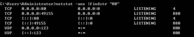

    Perform the following operations to check port communication:
    1. Run cmd.exe.
    2. Run the netstat -ano | findstr "Port number" command to obtain the port number used by the process.
      For example, run netstat -ano | findstr "80".
      Figure 3 Checking port listening status (Windows)
      • If the port status is LISTEN, go to Checking Security Group Rules.
      • If the port status is not LISTEN, check whether the web service process has been started and correctly configured.

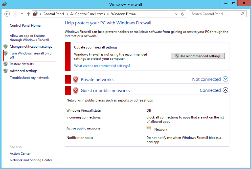

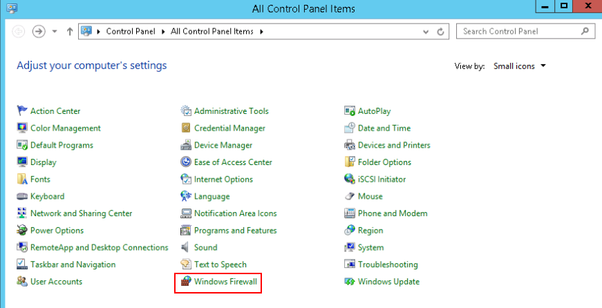

  • Windows ECS
    1. Log in to the Windows ECS.
    2. Click the Windows icon in the lower left corner of the desktop and choose Control Panel > Windows Firewall.
    3. Click Turn Windows Firewall on or off.
      View and set the firewall status.
    1. Disable the firewall and try again.

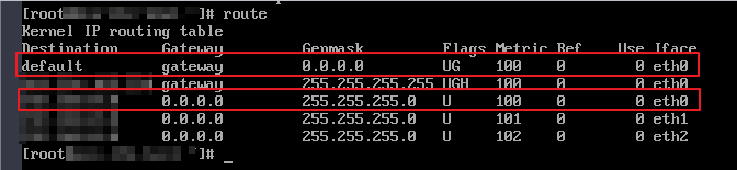

    1. Run the route command to check the routing policy. Ensure that the default route of 0.0.0.0 is destined for the gateway and that the IP address and the gateway are in the same network segment, as shown in the first and third lines in the following figure.

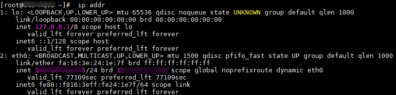

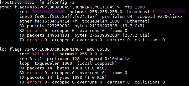

    2. Run the ifconfig or ip addr command to obtain the ECS IP address.
      Figure 4 ifconfig command output
      Figure 5 ip addr command output

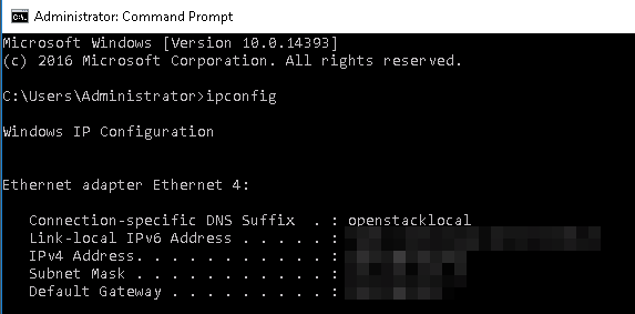

  • Windows ECS
    1. Run cmd.exe.
    2. Run the ipconfig command to obtain the ECS IP address.
      Figure 7 ipconfig command output
    3. Run the route print command to obtain the gateway in the routing table.
      Figure 8 route print command output
