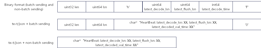

    If the heartbeat log output option is enabled, heartbeat logs will be generated. The following uses parallel decoding as an example: The heartbeat logs can be in the binary format. For a binary heartbeat log message, it starts with a character 'h' and then the heartbeat log content: an 8-byte uint64 LSN indicating the end position of WAL reading when the heartbeat logical log is sent, an 8-byte uint64 LSN indicating the location of the WAL that has been flushed to disks when the heartbeat logical log is sent, and an 8-byte int64 timestamp (starting from January 1, 1970) indicating the timestamp when the latest decoded transaction log or checkpoint log is generated. Then, it ends with character 'F'. TEXT/JSON heartbeat log messages that are sent in batches end with '0'. There is no such terminator for each TEXT/JSON heartbeat log message. If the receive LSN returned by the heartbeat log message to the receiver is 0/0, the replication slot ID cannot be updated. For details, see the following figure.

The binary encoding rules are as follows:
  1. The first four bytes represent the total number of bytes of the decoding result of statements following the statement-level delimiter letter P (excluded) or the batch end character F (excluded). If the value is 0, the decoding of this batch ends.
  2. The next eight bytes (uint64) indicate the corresponding LSN (begin corresponds to first_lsn, commit corresponds to end_lsn, and other values correspond to the LSN of the statement).
  3. The next 1-byte letter can be B, C, I, U, or D, representing BEGIN, COMMIT, INSERT, UPDATE, or DELETE, respectively.
  4. If B is used in Step 3:
    1. The next eight bytes (uint64) indicate the CSN.
    2. The next eight bytes (uint64) indicate first_lsn.
    3. (Optional) If the next 1-byte letter is T, the following four bytes (uint32) indicate the timestamp length for committing the transaction. The following characters with the same length are the timestamp character string.
    4. (Optional) If the next one-byte letter is N, the following four bytes (uint32) indicate the length of the transaction username. The following characters with the same length are the transaction username.
    5. Because there may still be a decoding statement subsequently, a 1-byte letter P or F is used as a separator between statements. P indicates that there are still decoding statements in this batch, and F indicates that decoding in this batch is complete.
  5. If C is used in 3:
    1. (Optional) If the next 1-byte letter is X, the following eight bytes (uint64) indicate XID.
    2. (Optional) If the next 1-byte letter is T, the following four bytes (uint32) indicate the timestamp length. The following characters with the same length are the timestamp character string.
    3. When logs are sent in batches, decoding results of other transactions may still exist after a COMMIT log is decoded. If the next 1-byte letter is P, the batch still needs to be decoded. If the letter is F, the batch decoding ends.
