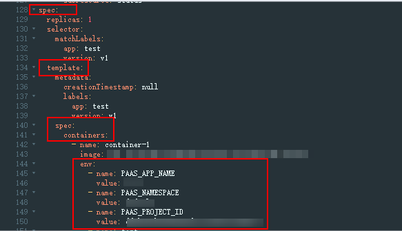

- In the displayed dialog box, locate spec.template.spec.containers.
- Add environment parameters to the end of the image field, as shown in Figure 2.
env: - name: PAAS_APP_NAME value: XXXXXXXXXXXX - name: PAAS_NAMESPACE value: XXXXXXXXXX - name: PAAS_PROJECT_ID value: 2a***********************cf- PAAS_APP_NAME: application name, that is, the name of the workload to be deployed.
- PAAS_NAMESPACE: namespace of the CCE cluster where the workload to be deployed is located. To obtain the namespace, go to the namespace page on the CCE cluster details page.
- PAAS_PROJECT_ID: project ID of the tenant. To obtain the project ID, see Obtaining the Project ID.
Replace the values of the preceding environment parameters based on site requirements.
- Click Confirm.

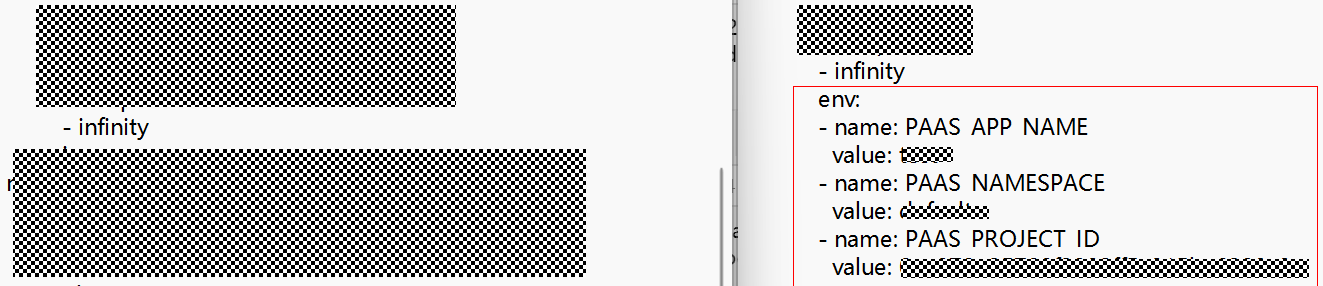

Solution 2
env:
value: XXXXXXXXXXXX
value: XXXXXXXXXX
value: 2a***********************cf - PAAS_APP_NAME: application name, that is, the name of the workload to be deployed.
